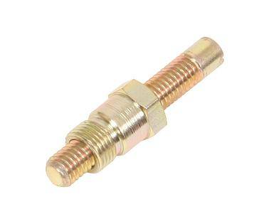

Might help if you get a top dead center stop also.
Yeah what Shorthorse said. So you can verify where TDC actually is and then compare to the 0° hole on the tab and the mark on the dampener. My tab was off by a degree and a half.
Yeap, doesn't matter if I have a timing mark I always confirm with the piston stop.
