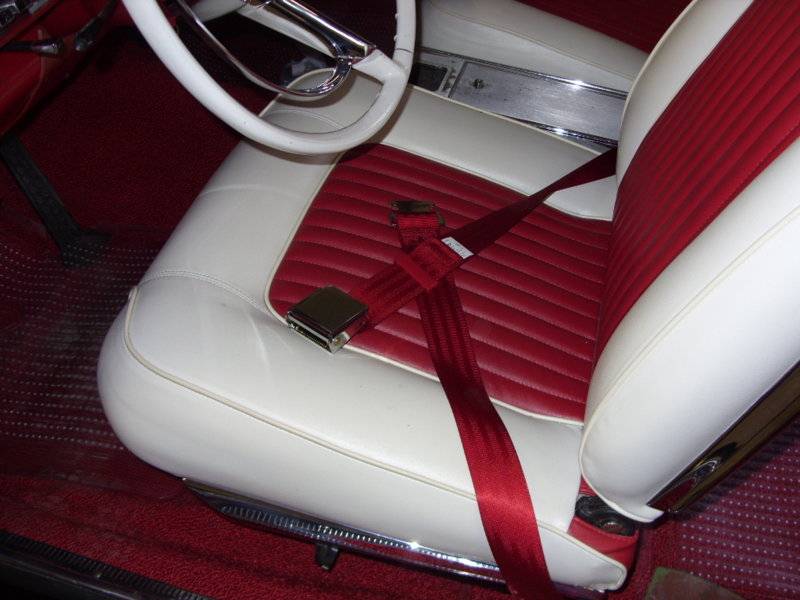

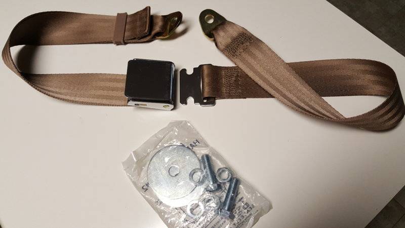

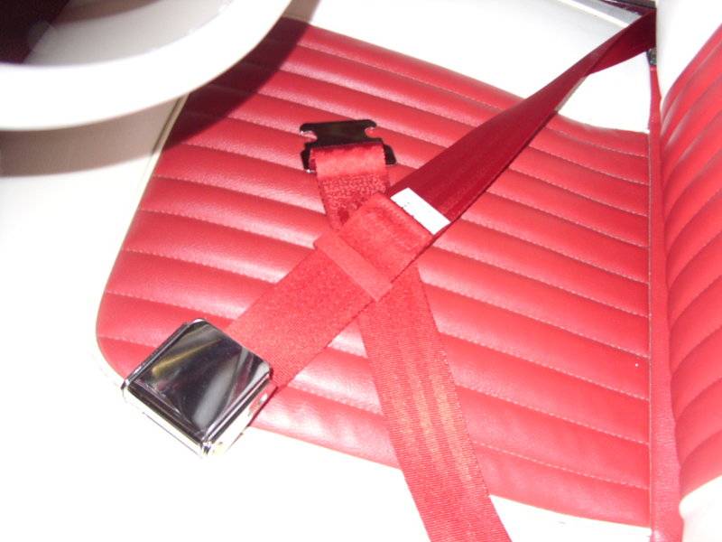

I went with Seatbeltsplus. Their hardware kits have the 7/16 thread bolts. 60" was too short for my '62 with bucket seats. 74" is what you want.
It did take around ten days before I received the shipping notice. They didn't have my color in stock. Belts came straight from the manufacturer in Florida. Good product for the money.
http://www.seatbeltsplus.com/product/1800-74.html

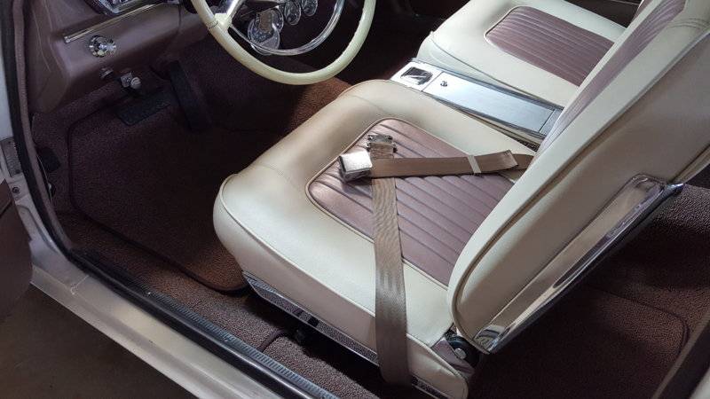

They're better than no belts. Nobody carries my color "rose beige" so I got the closest thing. They match the carpet better than the seats.
