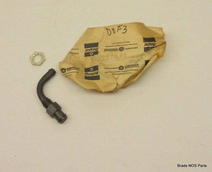

I recently picked up some NOS Mopar PCV valves. And decided to to do some comparison photos.

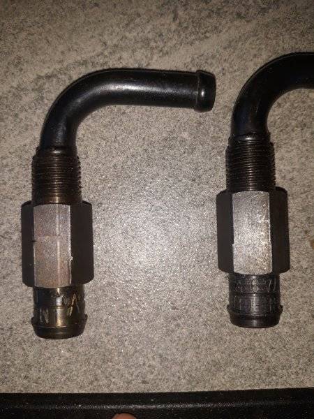

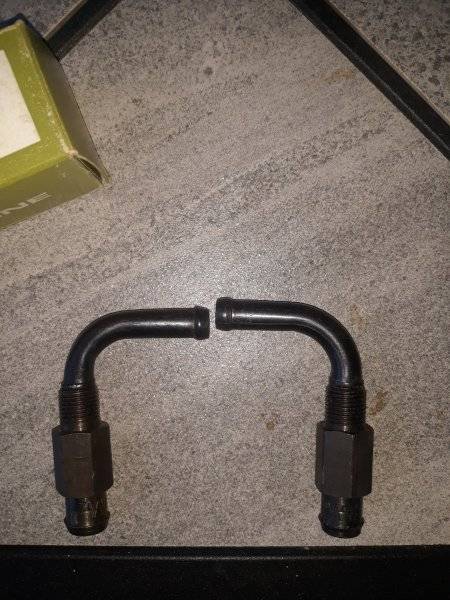

On the left is NOS Mopar OE pt #2808622 and on the right is an Atlas V-48.
For the most part they are identical. With 2 exceptions. The OE valve is maybe an 1/8 to 3/16" shorter in height. And the OE valve the markings are stamped ever so slightly deeper. But otherwise are the same exact markings . Even the hex barrel length is the same, threads are same. Only difference is the length of the tube before it makes its bend .
So it gives you options when looking for the correct PCV valves for the earlier cars. Which are getting harder and harder to find . I have multiple cars that use it . So I decided to stock away some extras. And between the 2 part numbers I have maybe 10 valves so I think Im covered,
For now !!!
So as I understand it there were 2 versions. On for 6cyl and one for the V-8. Maybe a third early on that could be disassembled. There is suppose to be a color coded ring on the inlet side that plugs into Valve cover. Basically a calibration of idle flow based on vacuum motor made.
Correct , the slant six valve is 2808441
Ive seen this shorter hex barrel version before. So maybe its slant six only ????????
And A LOT of sellers dont designate slant six from V8 , when apparently there is a difference. Maybe flow rate ???

The 622s I have here are short hex.
The 441 is gone.
hex nut in all my OE ones are a silver gold color with maybe a very very slight greenish tint
My Atlas one have no hex nut
Not the nut, but inside at inlet there is suppose to be color coded ring.

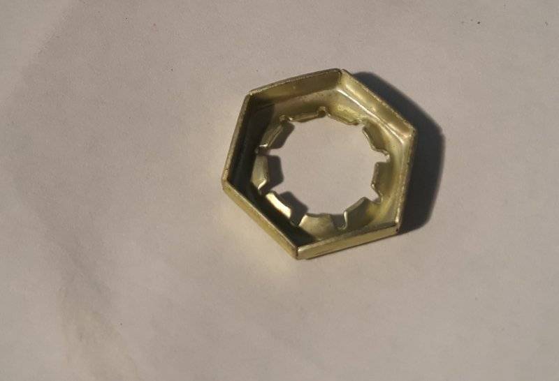

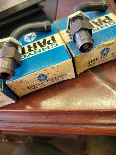

So I know this is an older thread but I was wondering what the Hex Nut was actually needed for that comes with the PCV Valve? When Mopars came from the factory did the PCV valves come with the nut attached to it or was it omitted? I have seen it both ways on hi end restoration pics. Just trying to find out what is OE Correct.
Last question Long shank vs Short shank PCV valves. whats the difference I have an NOS in the box from the 70's part number 2808622 and it has the short shank.
Thank you!
Reason for the extra nut was on early cars the PCV was on a metal can that slid down on a tower , later cars the PCV went in a rubber grommet
All hemis used the cap / tower arrangment from 66-69
Reason for the hex shape I can only assume was to aid assy on said tower type setups
Ah ok I get. I have a 440 with a grommet so it never made sense to me.
Did they leave the nuts on the pvc valve from the factory even when putting them on cars with grommets

The factory? No.
