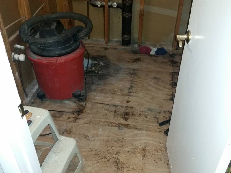

Finally . . . all cleaned up . . . Well kinda . . . see the "black" area on the floor by the location where the toilet use to be . . .

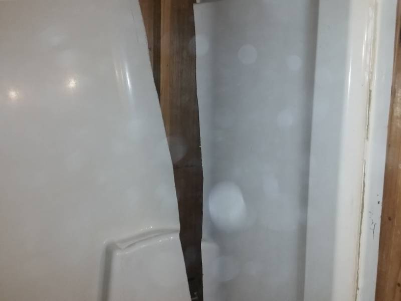

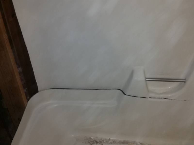

Oh . . . ant the tub - I think he tore out the door frame to get this "new" one in here - but, I HATE them . . . after years, they start to crack and leak. Will not take out the door frame and wall to remove it - so I cut the darn thing out . . . piece by piece . . .
More cutting and removal . . .
And the last of it . . .

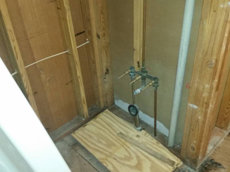

One of the MANY Side track issues - the new cast iron tub sits 3" closer to the wall, so the water fill is now NOT centered in the tub
- - guess who is going to have to go under the house and move some plumbing . . .
Plus - notice how they cut out a part of the wall joist . . . idiots . . .

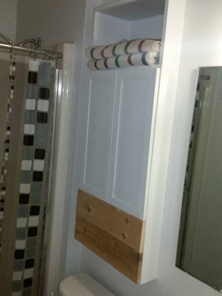

YET another Side track item . . . this wall, with the waste pipe vent, is a 6" thick wall . . . so, I've got extra space that can be used - in this picture you can see how I redid the framing and will make an in-the-wall cabinet ( from the other side - that would be the master bath ) . . .
Here is the beginning of the cabinet, in the master bath, that will take advantage of the 6" thick wall for additional storage . . .
Get it painted . . .
Add a couple full extension drawers to the bottom of the cabinet - to help store some things and make them easy to access . . .
Time to make a couple of doors to help cover up all the "junk" that would be stored in the center section of the cabinet . . .
More progress . . . door installed and painted . . . still working on the drawers . . .
Now . . . getting back to the bath . . . and the "rot" around the toilet from years of leaking water . . . cut out a big area and replace it with new plywood . . .

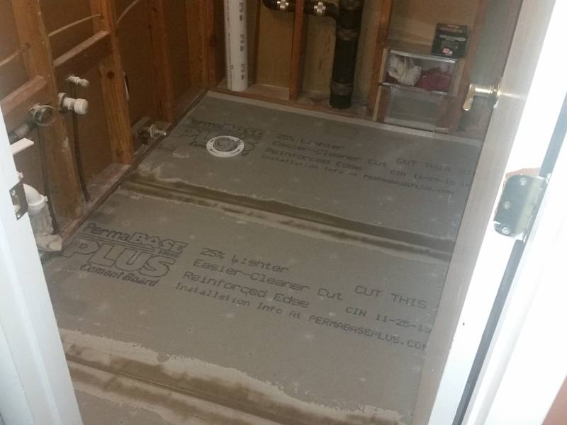

Now, to prepare the floor for the ceramic tiles - lay down some concrete backer board - Note - the toilet flange is not set permanently in place yet, just sitting in there to cover the hole.
In addition - having an on the floor register ( in a bathroom ) does NOT make any sense at all - so I moved the vent up the wall to prevent water from being able to "easily" drain into the duct work . . .

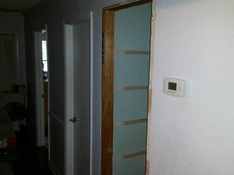

This "was" a linen closet ( Ugh, I think the whole house was painted that color originally ) that is right next to the bath ( the next door in line ) . . . so I got to thinking ( oh sh*t - the mad scientist is starting to take over control ) . . . what if I . . .
All of the shelves in this closed ( built in 1973 ) were wood shelves ( and I could reuse them . . . )
( and I still think that this color is horrible . . . bleach )
Notice the closed door . . . it is a hollow core door and it feels so cheap ( guess what another side task just might end up to be . . . )
So let's knock the wall out from between these two rooms and ( once again ) use the space a little more creatively . . .
