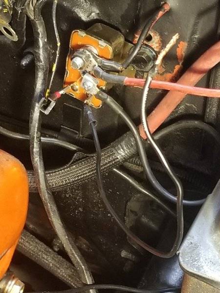

Here is a picture of the starter relay with the wire that isn't going to anything. The other wire that goes no where is under the console and one end is connected to coil. The wire in the picture goes to the starter relay on the right hand side bottom.

Ok several issues.
That bare wire is what is supposed to be the neutral safety. It looks like it was under the mounting bolt for the relay.
Second is the wire from battery stud going right through the firewall with no insulator.
That's a dangerous one.

Ok so look at your ground make sure that it is tight were it goes to the block, also look at your positive were it connect to your starter solenoid, the other wire that connects to the solenoid with the positive should feed your interior trace it through your bulk head connector to ign switch using a voltmeter or test light. you should be able to find the problem
So mount the starter relay wire going to nowhere goes to the mounting bolt of the starter relay?
Second, what kind of insulation does that battery wire need? I better get that fixed!

Automatic the wire should go to the switch on the Trans.

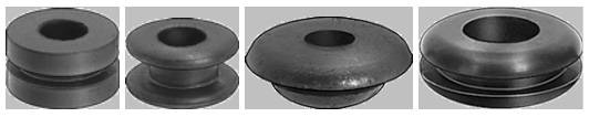

The wire going through the firewall would normally be in a bulkhead connector. At a minimum it should have heat shrink or a grommet in the firewall.
Any time you have a hole through metal, a rubber grommet should be inserted to keep the wire from rubbing on steel. Pick what works best.
in your picture in the upper left corner i see what looks like a wire connector eyelet, what is that?. the insulator he is talking about would be a round rubber shield so that the body does not cut in to the wire. that wire should have ran through the bulk head connector i believe.
