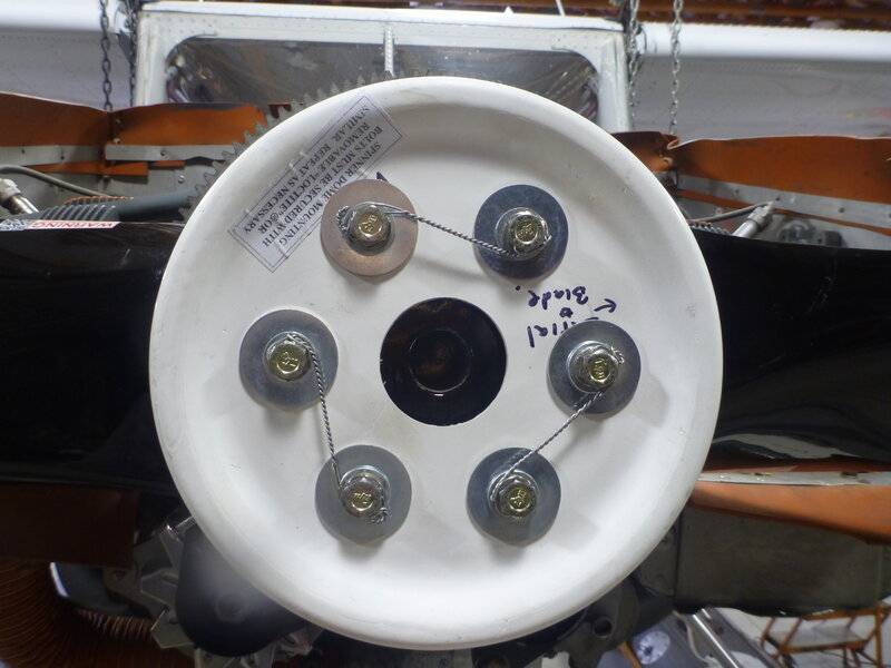

I helped a friend with his plane and lots of parts under the "hood" had stainless wire through them once torqued!!
Yep, generally a bolt into a tapped hole. Brake caliper bolts, prop bolts, etc... or anything else you don't want falling off!
