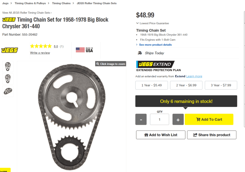

what is the preferred timing chain set here ? It can be a good one. I plan on keeping this motor and doing many upgrades later down the road.
This one should be good you want to have some adjustment for advance/retard if possible.
This is a really good price too.
You don't know for sure if you'll need it until you install and go to degree the cam.
NOTE: There is a 3 bolt timing set but that is typically only for larger lift performance cams.
https://www.jegs.com/i/JEGS/555/20462/10002/-1
