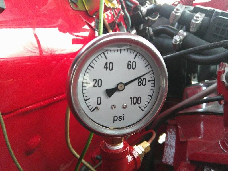

The Hemi block has a 1/2" pickup tube provision. Not the pump itself. I would put a mechanical gauge on the second oil pressure port at the back of the block, and see what pressure the pump is actually providing.
The Hemi block has a 1\2" pickup tube provision. Not the pump itself. I would put a mechanical gauge on the second oil pressure port at the back of the block, and see what pressure the pump is actually providing.
Why, he hasn't mentioned that he has a pressure issue.
