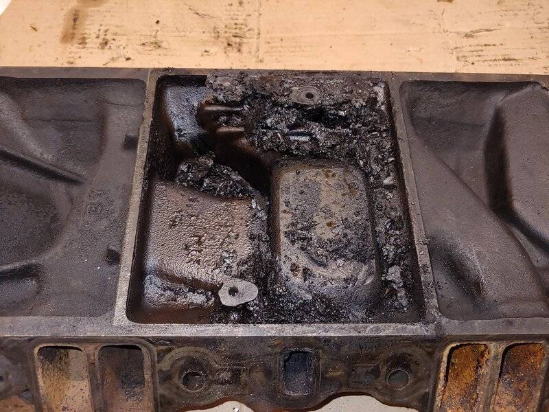

I am beginning a refurbishment of a cast iron intake from a 1973 340. It needs to be media blasted. I would like to remove the baffle plate from the bottom of the manifold. It's held on by just two blind rivets and was clearly never meant to be removed. It has to come off, however, because there's a ton of carbon chunks coming out from under it and I also don't want any blast media to get caught underneath it. If I grind those rivets off will there be anything worthwhile remaining to connect the plate to upon reassembly?
Also, what are the two nuts doing at the base of the plenum below the primary ports? Mine are pretty rusty and I don't want to hack them up trying to remove them. They don't align with the rivets in the baffle plate. So I'm baffled.

The baffle plate under the manifold should go back on. The hot exhaust cross over under the manifold will fry any oil that hits it without the baffle and the chunks will then fall into your engine.
Not perfect but it does sort of work. I have mostly found a lot of chunks/carbon under baffle plates were oil has not been frequently changed.

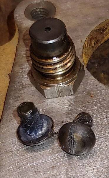

@ckessel Yes, you're correct. Not only were the orifices plugged but the entire "hollow bolt" was solid carbon up to and flush with the top of the nut.

Just for reference in case anyone has a similar question in the future, here's as example of one of the two "nozzles" at the base of the plenum. Also, the two twist rivets which held the baffle in place are also shown. I was unable to grab them with vise grips because they'd walk up the crown and pop off. So I simply cut a slot in the head of each one and unscrewed them with a screwdriver. They came right out.
