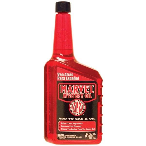

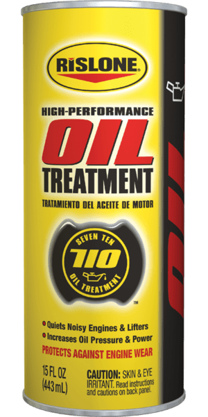

You're probably thinking of Rislone, or maybe Marvel Mystery Oil.

It's more likely to be a varnish that formed between the moving parts inside the lifter.
You can try Rislone in your engine first.
You could pull the lifter, soak it in Rislone for a couple of days**, disassemble it, and then soak the individual parts in Rislone for a couple of days.
**The factory service manual shows how to manually pump up a lifter once you have it removed from the engine. Manually pump it up with Rislone and then let it soak for a couple of days before disassembling.
Also, the parts have a fine surface finish. Don't mar the finish. Don't wipe the parts with a paper towel. Use 100% cotton (no polyester content) to carefully wipe parts if you must wipe them. Note: Some "cotton" cloths (including microfiber) have polyester surging around the perimeter.
