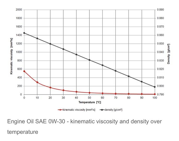

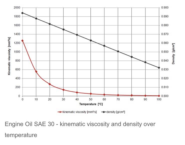

So here you go, 0-W30 vs 30. At engine temps all the same. Only difference is that the 30 will take 10-20 seconds longer to lubricate your dry engine when you start it.
