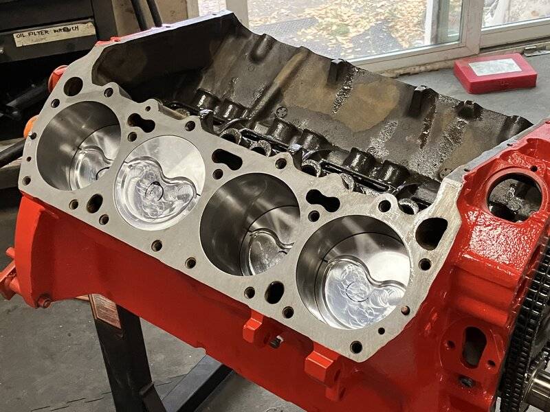

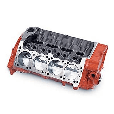

This is a topic that I never thought of. Oil drainback. Look at the picture of the deck of an LA series:
Here is a 440 block.
All I can see in both blocks are coolant holes and head bolt holes. Does all the oil that makes it to the rocker gear drain back through the lifter valley?
I see nothing that looks like an oil drain in the decks.
It all comes through the lifter valley on both of those blocks
It is interesting that the Hemi does have drain holes in the block. Thanks to the one that posted that info.
Oil has to go somewhere. Take a look at what you're looking at.
The lifter valley side of the hemi head is still open and oil from that side goes down the lifter valley. The head is so wide it needs the outer drain backs on the exhaust side or all of the oil in the engine would accumulate in the heads.
I was wondering about this myself.
It looks like it all has to run down over the cam.
