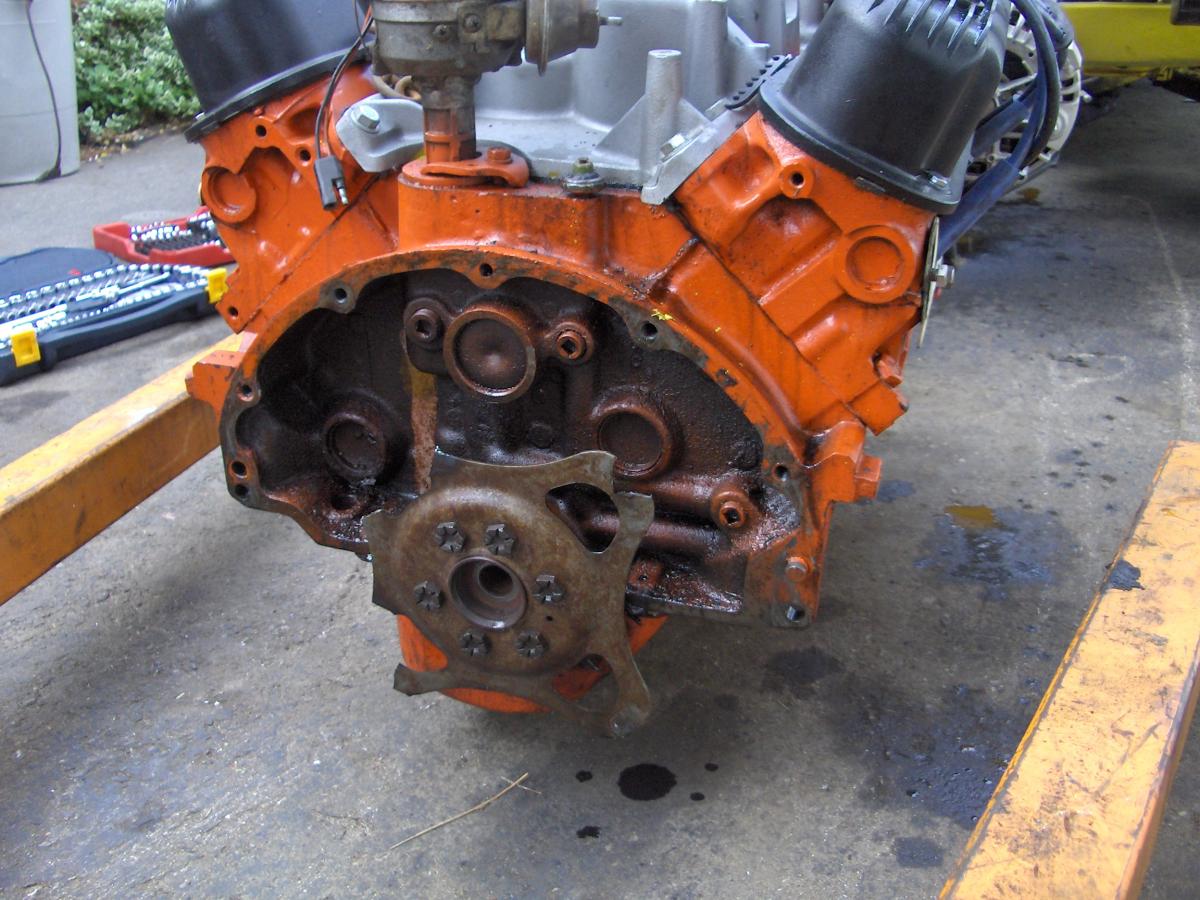

I had a chunk of flex plate snap off and stick in the back side of my oil filter, it made a hell of a mess and smoked like crazy,we thought the motor had blown lol
