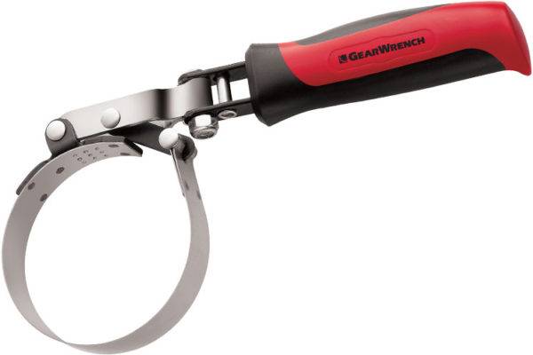

You need to buy a higher quality oil filter wrench. I like the KD/Gear Wrench strap type wrench.

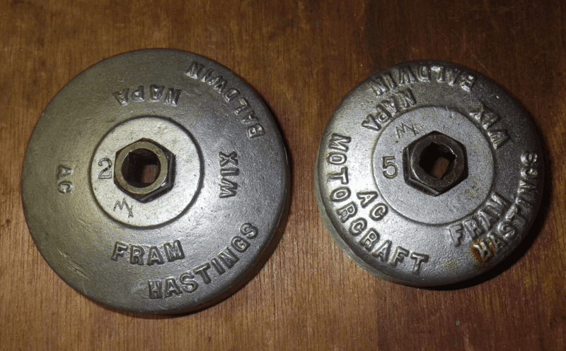

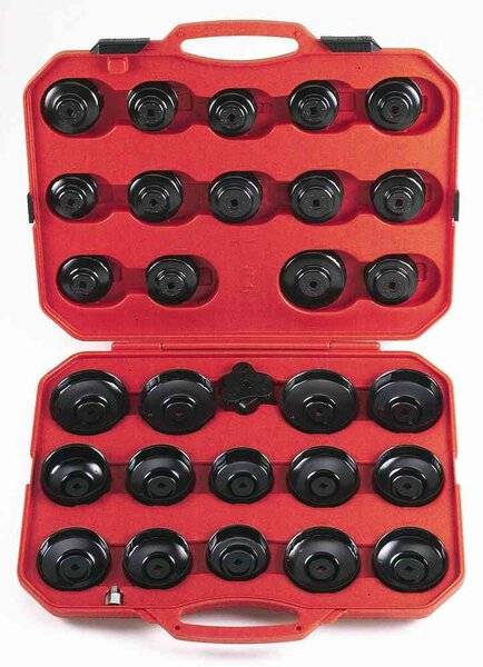

If you want a cup style wrench for the flats on the end of the filter, match one up at the parts store. There are many different sizes and flute numbers and that filter wrench probably won't fit much else. If you get a cup type, get a metal one if you can. They work better and last longer than the plastic ones. As you can see there are a lot of different ones.

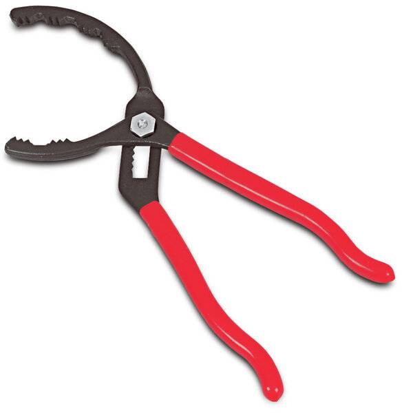

Always on by hand, but I prefer filter pliers for removal.

The two cup sizes I use, BB on the left BTW.......
