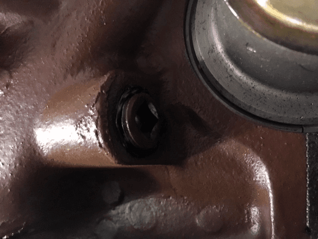

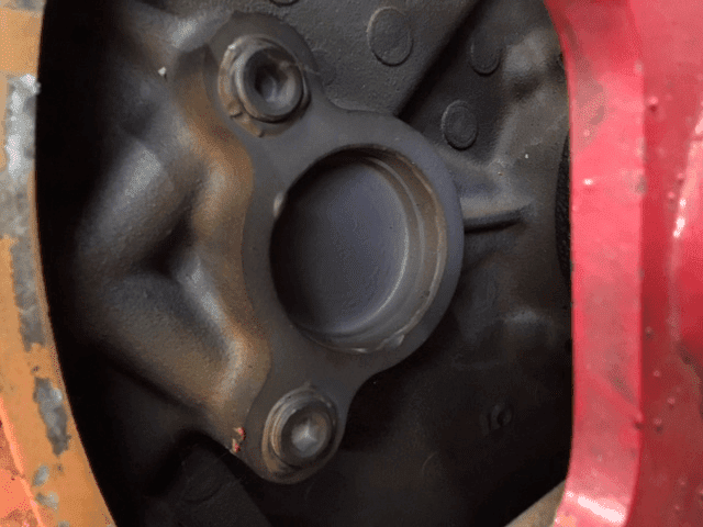

Hey guy's the title says it all i'm trying to figure out where all the allen head oil gallery plugs go on a 440. I had my block machined before building my engine and got back some plugs with it. I've been assembling the engine and there are 2 left with no home and I can find no place for them anywhere. I'm not sure if I mixed some others in while assembling which would account for the extras. if anyone knows and better yet could upload pictures showing the locations they go i'd appreciate it very much. Thank You

Thanks I definitely installed all of those I think I'm good. Extras must have come from machine shop.
Don't forget the oil ports up top on the back. Sending unit and the other should have a plug.
