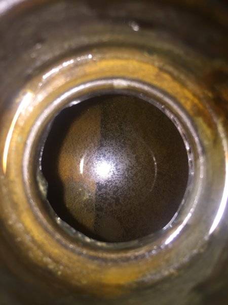

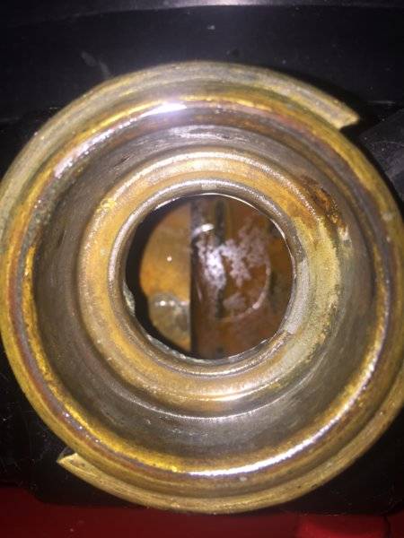

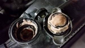

Hi , I have someting floating around on my coolant. Its not solid pieces so I’m worried it might be oil. The oil dipstick looks fine though , no sign of anyting but engine oil
What do you guys think?
That tiny bit of film could be anything. At this point you probably don't have any worries but it does deserve an occasional check. That is something we all should do from time to time. :thumbsup:
I agree with Gold Rush. Take a white paper towel and dab it on the surface of the coolant, it will absorb the coolant, but will also pick up the oil film.

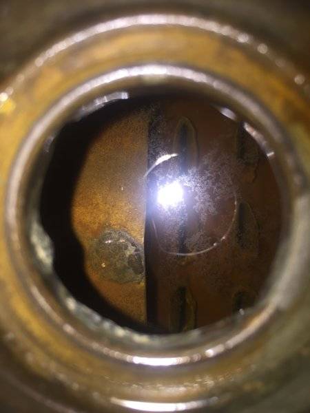

It almost looks like rust in the picture. Every cooling system I have seen oil contamination in ...the oil floats to the top and you would never see the radiator cores from the top and it looks milky. If it there is a little oil it will be in small round dark droplets floating on the top since oil does not mix w water or antifreeze. Most commonly water cooled oil coolers are the culprit if its oil. On automatics the oil in the radiator could be tranny fluid. But I agree w above on not to worry. I think it's just time to change fluid...until your sure its oil.
To me, that just looks like a little bit of the corrosion inhibitor in your coolant starting to come out of solution. I wouldn't worry about it, but if the coolant is 3 yrs. old maybe change it? My coolant looks just like yours and it's fresh.
I would drain your oil and check for coolant in the oil. That would be a bigger problem. Like others mentioned, that doesn't look like oil so much as corrosion.
I don't think you have anything to worry about in those pictures. A drop of WD-40 in a bucket of water would look the same.

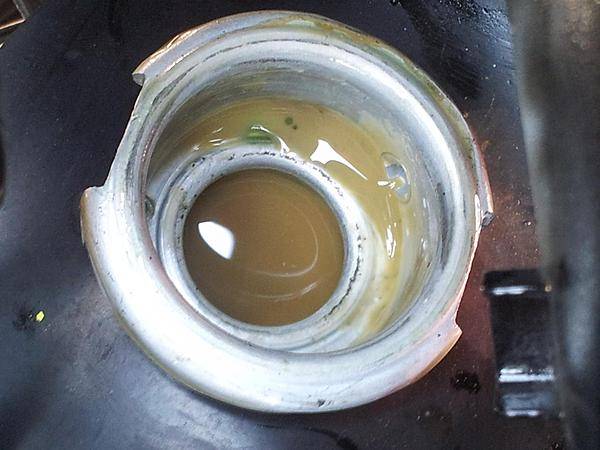

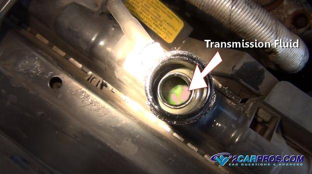

If it would look like this you would have a problem

I’ts actually just a few months old. My thermostat failed to open a couple weeks ago. Drained a few quarts to change it. I did notice the coolant was already bit rust Coloured. At least not 100% fresh looking. I’m planning on draining and flushing everything within the near future

You need to flush the cooling system with a rust remover and use distilled or Demineralized water along
with the coolant. Keep the ratio at 70% coolant and 30% water.
Yes, drive it with distilled water & radiator flush for a couple days, drain & replace with new 50/50 antifreeze (or other blend as mentioned above). That coolant you used is a "dexcool type" and works just fine in our Mopars. There aren't really any "inorganic additives" in that type of coolant, so I think you're seeing a little bit of dirt or rust floating in there.
