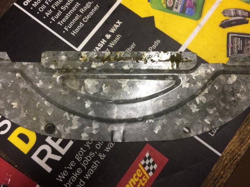

Just had my oil pan gasket replaced for the second time in two years I also had rear main replaced two years ago. I was wondering is the rear main bad again or if it’s normal. I’m getting tired of throwing money at shops and the leak not getting fixed. Here’s a picture of trans dust cover where I’m see oil. The leak is not has bad has before oil pan gasket gasket was replaced the second time.

you got a proper pcv setup?
I was wondering the same thing. I ended up putting a hose clamp on carb side of the pcv hose maybe im not getting good vaccum. Using 3/8 fuel fuse.
pcv valve on one valve cover, breather cap on the other.......... clean air gets pulled in through the breather cap, across the engine to the other side and through the pcv valve..... if the breather is clogged, or doesn't exist, there is nothing for the pcv to suck
been a while but I remember being able to remove the breather cap and put a dollar bill over the hole to check for suction.........

Not feeling any suction from valve cover but I do from the pcv valve.
