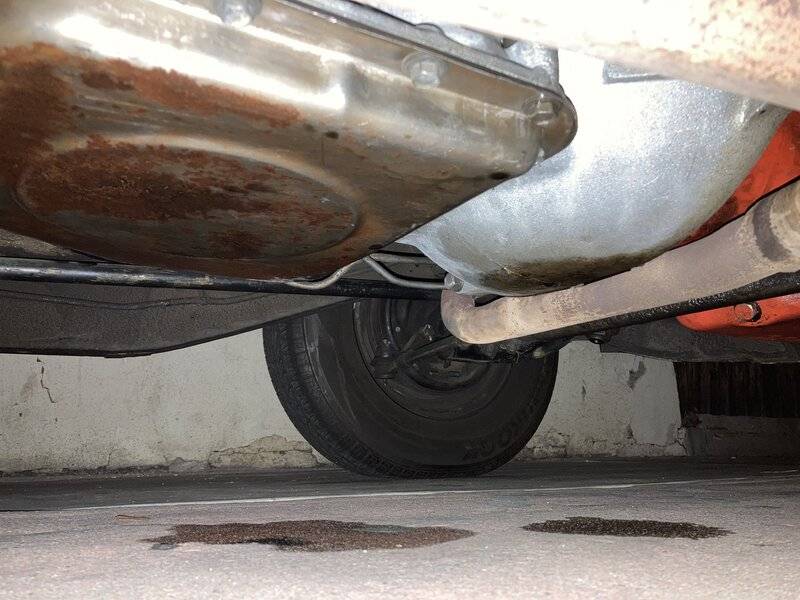

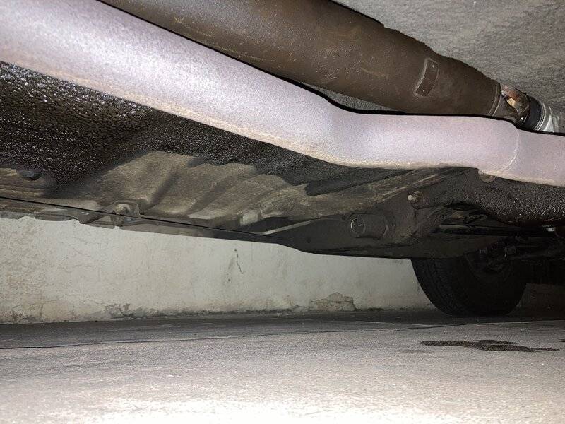

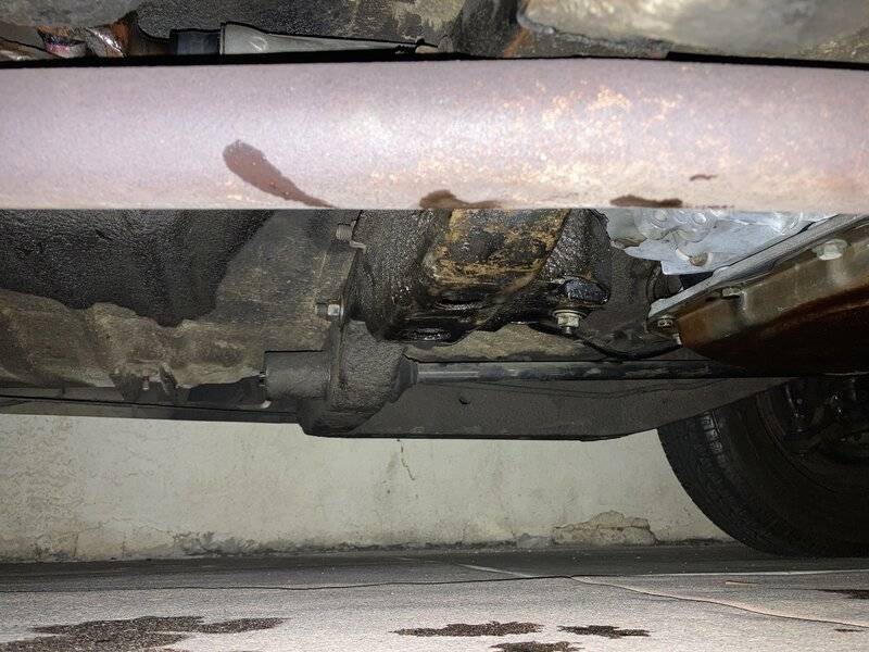

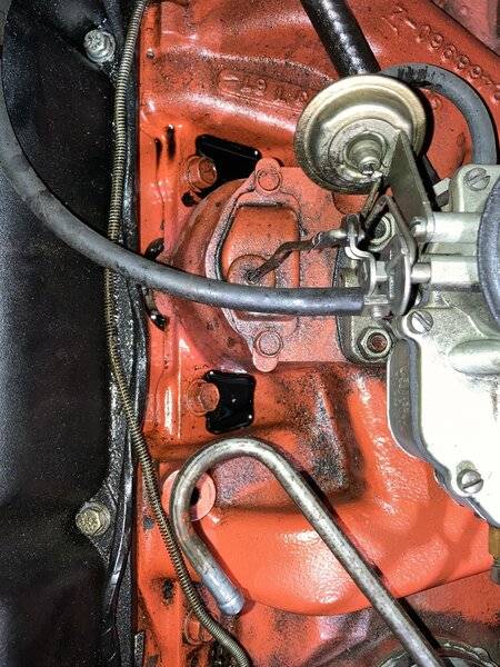

I've got some oil leakage in my 68 Satellite's 318. It mostly is in the form of little pools in the crevices of the intake manifold. There is also a thin coating of oil residue everywhere on the engine bay so it's really hard to pinpoint exactly where it's coming from. And now I'm panicking a bit because the transmission was just rebuilt past couple weeks and theres oil on the front of it. Looks like motor oil though... Can the engine oil be leaking onto the outside of the transmission? I also noticed a lot of oil on the underside of the car in general. I need to deal with these leaks asap. Any insight appreciated.
The oil pressure sending unit is on the block behind the intake. They can leak and the oil runs down the back of the block and front of the trans. But I also think, by the picture, that you have valve cover gaskets leaking too.
Oil travels up the intake manifold bolt threads. Pull one at a time clean and seal with Permatex #2 or silicone sealant.

Red "X"... Oil won't travel uphill from the intake bolts. If you notice, the smiley face where the exhaust crossover passage in the heads is filled with oil, and not even close enough for oil to get there from the manifold bolts. The valve cover lip and bolt areas are covered in oil, so my first choice is leaking valve cover gaskets. Fix that first, then go from there.

I have to disagree somewhat. I have a newer built 360 that I did myself and I see the oil coming from the intake bolts and staining the intake.....it ill travel up through them if you don't put a bit of silicone or sealant on the treads when installing. I agree in checking the valve covers first in this case because that's alot of oil, but the oil will come back up through those pesky intake bolts and stain/add residual on the intake as I found out the hard way. I gotta pull them one by one and get the threads sealed up in the coming weeks.

I didn't mean to infer that the manifold bolts can't leak, they do. I only was saying that in this example, it surely looks to me that the valve cover/bolts are leaking due to the amount of oil above the manifold bolts.

Totally agree with that. That would need to be run for years like that to pool up that bad. I had issues when they were trying to run my big block without a PCV valve and the pressure built was pushing oil past the gaskets just like this. Either way, I would look at the valve cover gaskets. It can also come out of the rear corners of the covers if its leaking bad enough and puke down on the trans bellhousing area.
I had oil on my exhaust pipes just as you do in your picture. It ended up being a leaky valve cover in the far rear corner. Blowing back. So hard to see unless underneath with a mirror and flashlight. A rag/bristle brush with some paint safe solvent and a few hours will go a long way to cleaning off all that residue to identify exactly where the leak is after the next start.
are those black crinkle aluminum valve covers? I think they might be hitting the high points on the intake may need thicker gaskets

I stand corrected. I didn't see the twisted rocker cover gasket either.
