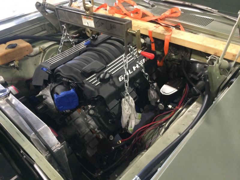

Well, here's the basic gist of it - mating the 6.4 to a 727 with gearvendors overdrive!

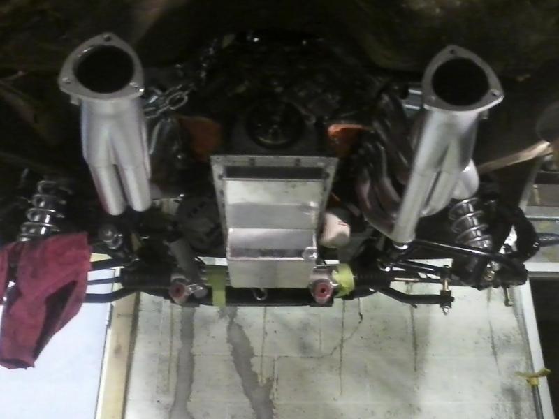

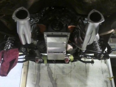

i got the charlies oil pan. its pretty nice. nobody knew the oil capacity for it except s&p they told me it is 6 quarts not 7 like the factory one. that 6.4 looks good sitting there.
