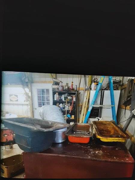

Building a 440 for my 70 rr was wondering which if any one 0f the oil pans would work in my car I have a402 stamped pan orange one ,a 187 stamped one it's yellow one and I have a modified deep pan with adjustable sump ,which one would work for my car and clear the steering etc.? Didn't come with an engine was a 383 originally in car.

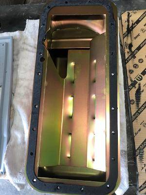

The 402 pan would be the original pan used. I think the 187 pan is an A body pan iirc. I would upgrade to the 6 qt “hemi” pan. Pickup tube and pan are available as a packaged deal for a pretty reasonable price.
Got one off E bay 5 quart pan for around 60 buck's with shipping and all. Fit 440 and 383. Used same pic up tube. It was about an inch from the bottom. Figured it would not be sitting in the sludge and getting plenty of fresh oil. Oh it was non painted. Company out of CA.
The 187 pan is a C body pan also used for A body BB conversion. That pan will probably rub on the center link in your 70 B.
The 402 is the BB B-body 5 qt. pan. 5 qt. with the filter.

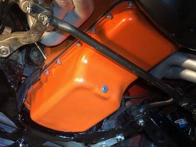

I would get a 6 qt. pan like the one Kern Dog has. There are few to choose from.
originality doesn't matter much but fitment and drivability does, just wondering if deep sump would be to low otherwise I'll use the 402 ,my car is altered in many ways. Just never had a 70 re and was looking for experience, thanks for your help

Look at the link I provided. As I said, the 6 quart pan at the top is the one I use - and it hangs exactly the same
as the stock 5 quart does, no lower at all. Clears everything under there just fine also.

One key point from my own experience - "hemi" pans & pickups are not all the same. Make SURE to get the pan & pickup from the same company
