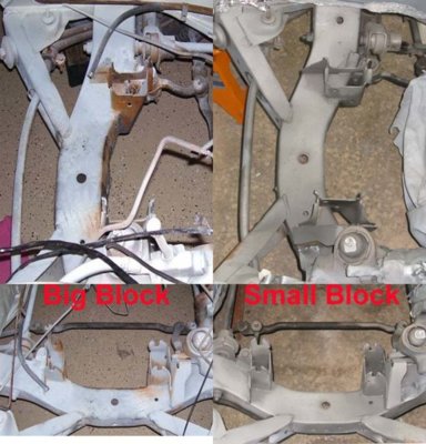

i’ve got a 76’ doba with a 360 that I’m starting a 440 swap. Bought a 77’ 440 HP (cop motor) that was rebuilt and bored 10 over but was in a motorhome and was told it had a truck pan. I had the understanding that I would need to swap out the oil pan to a b-body style but that looks like it will interfere with a crossmember. The current 360 pan sits forward of the crossmember and it looks like the current 440 pan will too. Am I all messed up or am I missing something?
Silly question....you did change the crossmember to a big block crossmember?

I have a donor big block cordoba to swap the torsion bar, and k member (if needed as I’ve heard they might be universal) I haven’t even pulled the 360 yet so this is really just starting. Just trying to get my ducks in a row before I start.

It's a really easy swap - almost like the car was made for a 440. Some years back I took a 440/727 out of a 77 NYer (common donor) and dropped it in to my 75 Charger. Just by accident I swapped in a k frame from a 400 car and it all dropped right in - except the oil pan. Grabbed one from a 400 Doba to fix that. Drive shaft too. The C body exhaust manifolds and kick down linkage worked.

Thank you for the help. I’m taking measurement now of the two k frames and they seem identical. Same distance to the mounts....same height...
it sure looks like everything on my current Doba’ w/360 is the same as my donor that had a 400.
You said that you changed the k member by accident??? Did you not need it like I’m thinking I don’t need it as well?
If ya know Dobas, ya know the K frames rot. Over the years I've randomly grabbed good spares when I find them. Before doing my last swap I grabbed my spare front end to paint, replace bushings, etc and get it ready to go in the car. The accident part was grabbing the spare big block k frame.
The factory parts books do list different PNs for SB vs BB but I never thought it was an actually different part because a) Hollander interchange didn't mention it [back in the day] b) they list different PNs year to year c) never ran in to problems with the few I replaced without paying attention to it.
Within the last year I came across this attachment that shows the difference pretty plainly.
That’s exactly what I thought. My frame is perfect. The original owner (I bought it from his son) undercoated it and never drove it during the winter. No rust and I mean NO RUST. The donor car k frame is ok.
