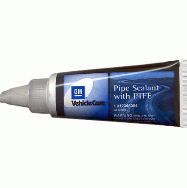

And I use a little GM liquid Teflon on the oil pan bolts.

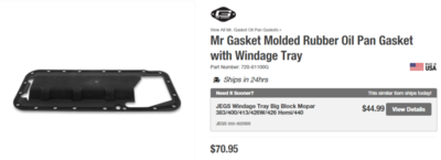

I was always told, "It ain't a MOPAR if it don't leak"! :lol:
Lol, sooner or later it seems they start. I slide the bottom half of a cat litter box under mine. Maybe I should buy these for it'.....
