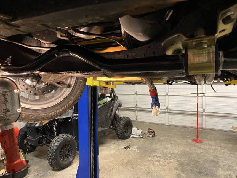

Yes, you're right. I would put a skid plate on my K-Frame to make the Road Race pan. Here's a pic of one on another Member's car:
I guess I'll try to duplicate this somewhat . I really want seven quarts in the sump. The Stock Hemi pan will only give me six, and I don't
know what I have to do to it to put my external pickup in that pan. No one wants to rip the bottom of their oil pan out!
