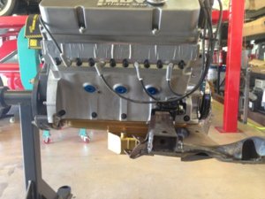

Milodon 31580: 7 quarts plus the filter. No sloshing. But I get that it's not exactly "period correct" if that's an issue...
