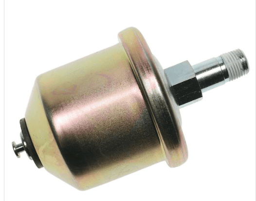

So, my 71 Superbee 440 has been showing very high oil pressure, so I though I would start by replacing the oil pressure sensor on the back of the engine. Start with the simple things. I purchased a generic sensor, even had a male and female connector on top. Now my oil pressure barely moves the needle.
Hard to believe the new one is bad, but is there a more specific sensor I need or are they really all generic? I suppose I will put the old one back in, is there something I should do about cleaning it first?

"I purchased a generic sensor, even had a male and female connector on top."
You can't throw a sender on that is generic and not matched to the needs of the OE gauge & expect it to work....
You need a STANDARD MOTOR PRODUCTS PS59

OK, got the correct pressure sensor and installed it. The dash gauge now moves to about the 75% mark and fluctuates a little, which is what I expected. So, what did we learn?
1. "universal" isn't.
2. They do go bad.
