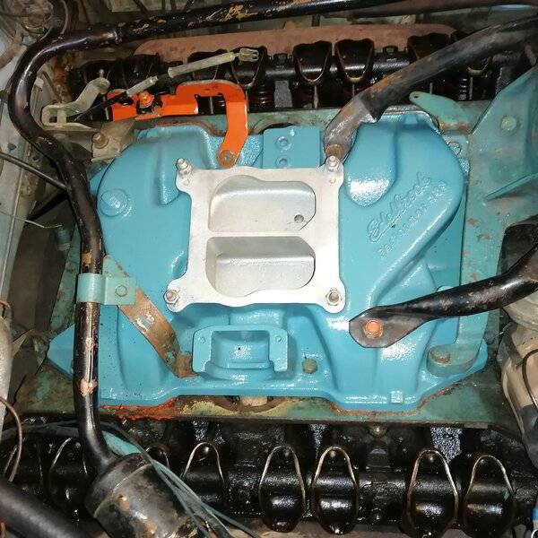

My 1966 Charger 361 has an oil pressure sender that you can just see in the bottom corner of this picture. I was going to order a replacement. Rock Auto shows that type of sender for an oil pressure warning light, and the large bell type for a gauge. It works fine most of the time but has cut out on me, particularly when the headlights are on for a long period. I would like to replace it. Which type is correct for the 1966 Charger with a gauge? Can't be sure if it was original or previously replaced.

the bell type is for a gage. the small one is for a warning light
That's what I always thought, but this one was working?
in my years of wrenching i have seen that a small sending unit was used from the factory and some aftermarket parts for the gage . but now days i think it is the bell for the gage and the small for a warring light are available.. your old one looks to be larger than the warring light one.
