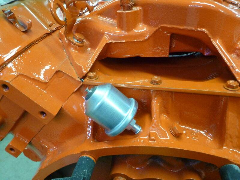

Can anyone tell me what size are the taps for the sending units? I've purchased an oil pressure sending unit to tie into my EFI (1/8") and all I can remember is its bigger than that.
I've left the shop already and dont want to go back to measure for the adaptor.
Thanks
1/8" NPT on the drivers side and 1/4 on the passenger side of the gallery.
Thanks ,have the standard sensor in on the drivers port. Needed the the passenger side.
