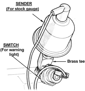

If it's just for a warning light it should have a female spade connector

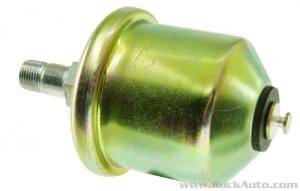

This is the one that I have on my car, should I buy a different one?
Isn't that the gauge sender?
The switch is smaller.
The sender shown above is what I have installed, which is a gauge sender for the Ralley dash.
