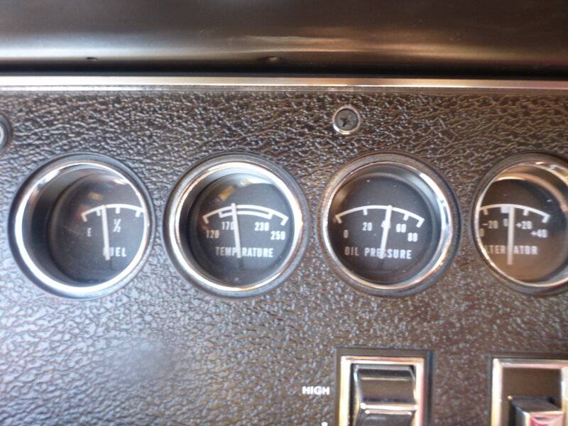

Running a stock 78 400 4bbl motor with 57k miles. Everything looks perfect inside. Just got it fired up the other day for the first time since getting it. Wix filter and 20 w50 (didn't realize it wasn't 10w 40 until I was home) VR1 oil. Cold she hit 80lbs, once she hot between 40 and 50. Is that too high of pressure? change to 10w 40 or is the 20w 50 ok for now? Thanks!

I think you are good. Every engine is different depending on the tolerances. I have one Hemi that is 85-90 cold and 60-70 warmed up and no lower than 50 idling at 185 degrees. No problems with 10K miles on the build.
I was running 20/50 hi-zinc racing oil in my rebuild and pressure was always pretty high even when hot. I switched to 10/30 and pressure came down - the reason I switched though was also due to engine heat...reading up on higher vis oils retaining more heat. No clue if that made a diff since I had already done some other things to lower temp. Articles on oils referenced lower vis oils for street driving...higher for racing...seems as though your getting good range so just my two pennies.
Other than waisting the hp to build unnecessarily high oil pressure I don't know what it would hurt?

Cold pressure is only a measurement of resistance to unwarmed oil. 40-50 hot on a street motor is fine.
