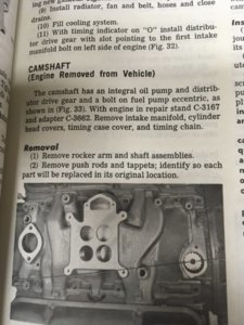

Then at TDC where should the rotor be pointing?
Here you go for gear location.
Well in that case ,,,,,prime the bitch TDC it and drop the gear in!!
Thanks oldbee! So is that line the rotor pointing direction? Is that from the manual? If so I can check it out and read abd learn more.
Hemitis unfortunately I just today hooked up the battery for the first time and nothing. At least there was no fire but I git another job agead if me. Can’t wait to find what Bubba did with this system lol.
That line should be the slot in drive gear, rotor should be pointing to #1 in your cap. Sorry SB’s aren’t my area too much.
Also I believe that the SB dizzy rotation is CW so I assume you were thinking BB for CCW primimg rotation yes?
Ur probably correct. The drill will tell u if ur rotating wrong.
