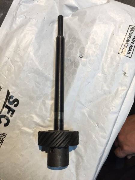

I got this on the pic in my disassembled 383 with a Melling HV oil pump.
I am making a stroker out of it with a hyd cam.
Didn’t see any part number on the shaft. It is tapered and pinned (as seen on the pic). Can I reuse this one with my build?
