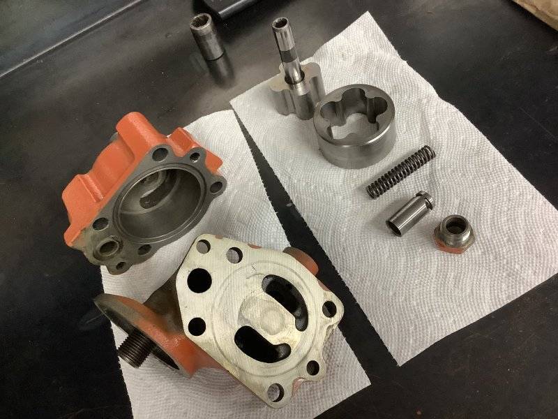

I’m at a loss here, trying to get the oil pump to prime. Turning the pump CCW (440) I even bought a new 1/2” drill thinking my 3/8 cordless didn’t have enough speed or power to get it done. No joy! I resealed the engine and changed the pan, the pickup to pan clearance measurement was 3/8” so I didn’t mess with the pickup at all. I did disassemble the pump (Mopar HV) to replaced the gaskets and inspect the pump, which looked great inside. I just pulled the oil filter and it’s bone dry. Before I remove the pump, what am I missing?

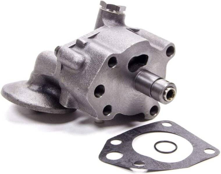

One of the reviews at Summit says the Milodon gasket is cut incorrectly and blocks one of the holes.
I'd take a look at that first.
Milodon 21591 Milodon Oil Pump Gaskets | Summit Racing
I think you and 3wood are onto something. The old gasket tore when I took off the pump so I probably didn't compare it to the new one. Looking at photos of oil pumps online I see the port that would be obstructed by the gasket from the Milodon gasket kit I used.

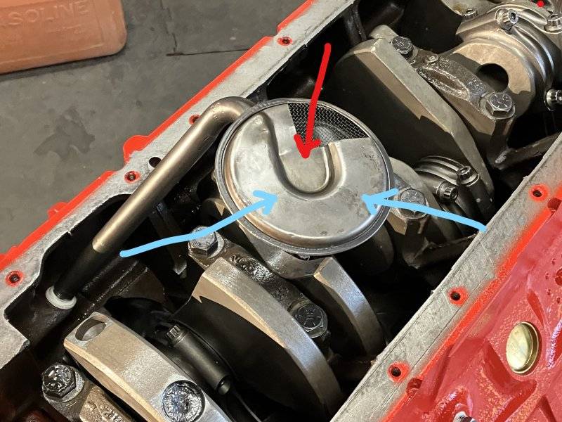

First, if this is a stock pickup, you should have it against the bottom of the pan. They have a built in recess....
The blue arrows point to what should rest on the bottom of the pan. The red arrow points to the recess. If you're 3/8" up using this type of pickup, it would be like your fuel sender pickup sitting 3/4" up from the gas tank floor. You'd run out of gas with 2 gallons in the tank.

It's a Moroso 1/2" pickup made specifically for the Moroso pan I'm using. The more I think about it, I'm 99% sure 3wood and OKDart are right about the gasket. I have to pull the pump regardless, so it will be obvious if that's the issue.
