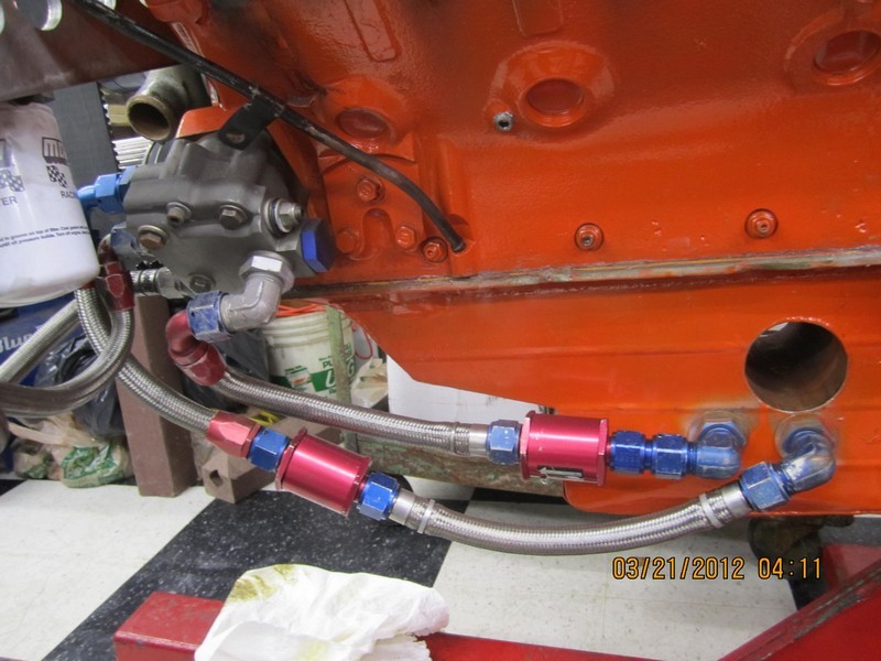

Street car??Race car or both?What oil pan will you use?
Street car....may take it to the strip once or twice just to see what it will do, but it will spend nearly all it's life on the street. I'm setting the rev limiter at 6500 RPM but I'll plan on shifting 5500-6000 most of the time.
I'm running a Mildon 7 quart pan like this.
That Milodon system is really nice. I have used those and Titan. Really, you would be fine with a regular Melling high volume pump as long as your top end restriction is set up as needed.
