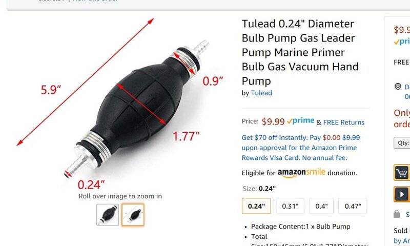

If you have a handheld vacuum pump used for bleeding brakes you could possibly use that with a hose long enough to reach the bottom and use that to at least get the siphoning started, then into a container.
Note they make up to 1/2", handy to have around.
^ What Fran said. There's cheap ones at Horrible Freight. I have some 1/2" vinyl tubing with a big 7/8" nut zip-tied to one end. Push it a ways down and hold your thumb over the end, take up the slack quickly.
