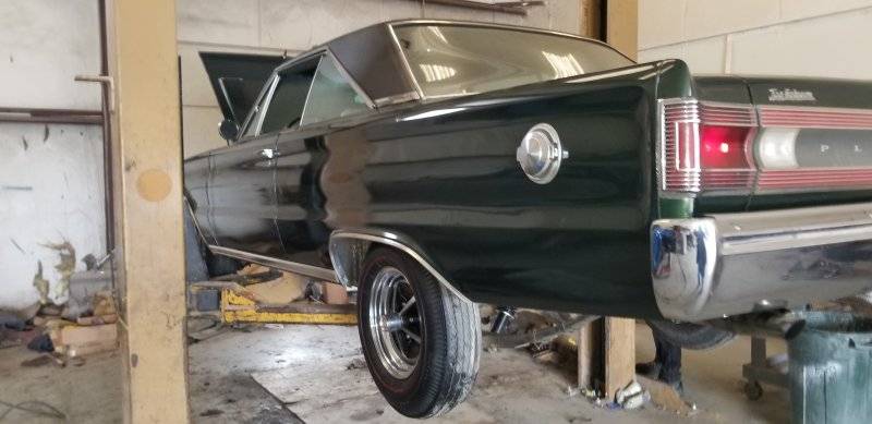

I have a set of tires on my recently purchsed 67 Coronet that are in new condition but from 2001. They have no obvious dry rot or cracking other that some hairline cracks on the inside of the tread.
Any thoughts on driving on these tires and safety aspect?
The car was kept in a temperature controlled collectors barn the past 20 years and barely driven.

Thank you everyone. Now the question is... what do I buy and where. Sounds like Coker is the place to go. Now what to buy. I have P215/70R 15's on it now. it's a 1967 Coronet 440 with steel rims and dog dish hub caps. I don't understand back spacing etc. so any info you guys have would be great.
I am also going to upgrade the rims asap once the budget allows.
