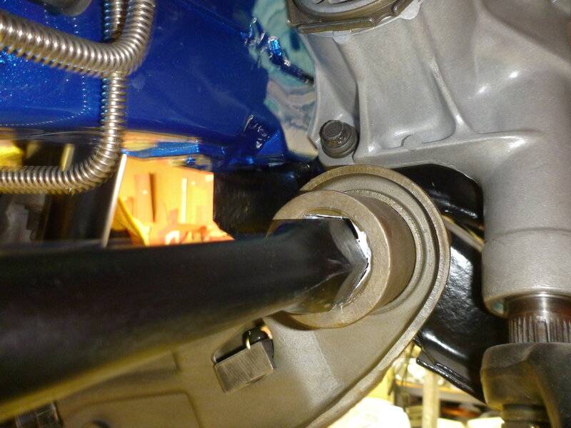

Loosen top shock nut.
dadsbee...It seems that when I rotate the adjusting arm or the control arm that the socket is not rotating. I'll get into again after work today. You pic reflects my situation perfectly.
Well I can tell you if that socket is not rotating when you move the adjusting lever then you have a major problem !!
