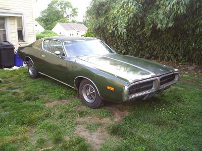

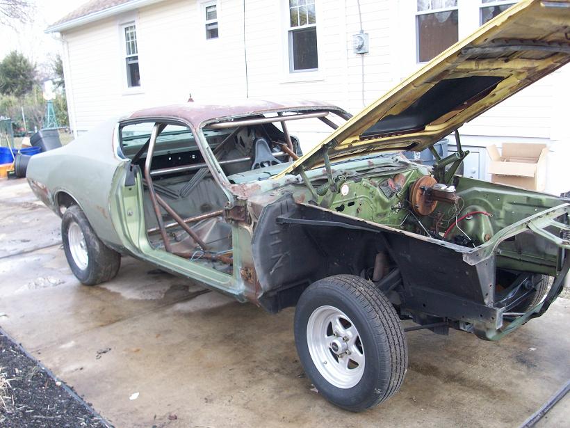

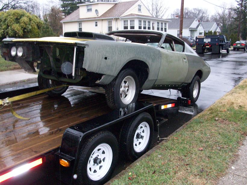

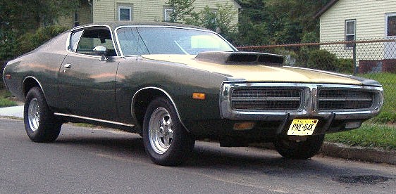

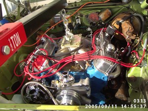

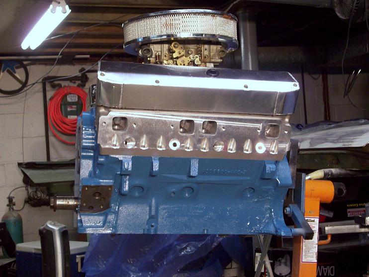

here is my charger that i bought when i was 19 i love it cuz my dad used to have the same car.i sold my 66 coronet to finiance the build.boy was i wrong i ended up with a 440 dressed and a transmission built.i still needed a rear and everything else to make a 440 work in a small block car.well i pulled through and got the charger runnin then i wiped 2 cams.while the motor was out i thought hey ill strip it and get it painted,another mistake,its been apart for two years in my driveway.well now me my best bud and his friend are gonna hit it hard to get the body finished. the motor is about ready and materials are bought for body. here are some pics in order before after then before and during the current work,kinda hard to follow until the pics are posted.let me know what your thoughts are,thanks jeff

now at the body shop gettin it finished and i got me a new bullet that im finishing here at home
Make sure you check the level of ZDDP in the oil you use. You really need something that is 1200ppm or higher with a flat tappet cam. Could be why you lost the other cams
