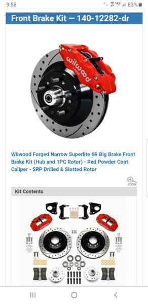

I want to use these 6 piston front discs:
https://www.summitracing.com/parts/wil-140-10815-dr
12.88" disc, 6 piston fronts

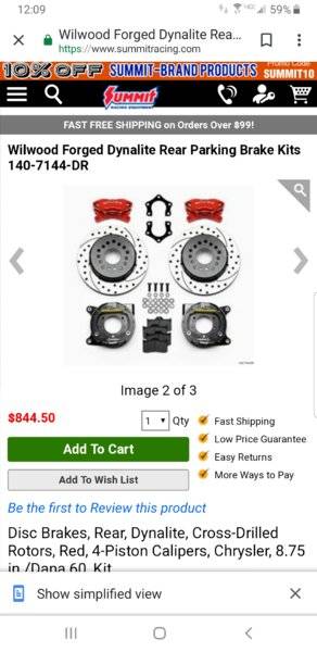

MY QUESTION IS if I use those front discs, I would want to use these for the rear, because these work with a 15" wheel, and I may need a 15" rear wheel for track day slicks:
https://www.summitracing.com/parts/wil-140-7144-dr/
12.19" diameter disc 4 piston rear
ANY PROBLEMS WITH MIXING THESE 2 SIZES AND PISTON COUNT?

Those brakes are top notch as you already know, so I’m sure you’ll love them. My struggle with rear brakes was also making sure they would fit with 15” wheels.
Not all 15” wheels are equal, and 12.2” discs are quite large, plus you factor in caliper clearance and you’re quite likely over 13.2” (remember a 1/2” increase on one side is doubled on the diameter). Whether or not that’s enough for the 15” wheels you want is anyone’s guess and depends on the wheel’s inner profile. Their product page says “may fit some 15” wheels” so just be aware. Maybe if you call they can give you a list of wheels they know to fit that kit?

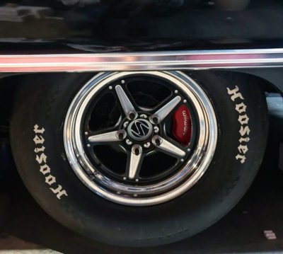

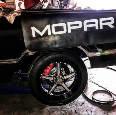

Bio, I run those brakes on the rear of my coronet, the critical measurements are going to be caliper clearance and backspace of the wheel you choose. I run 15” billet specialties street lites, first set I order we’re 15x8 with 5.5” bs and they didn’t clear the caliper! Exchanged for a 4.5” bs and it clears by a hair. There is a step on the barrel of the wheel where it goes down by .5” or so that’s where I was hitting. I run the 6 piston up front with a 17” with no clearance issues whatsoever.
750C59FF-9BE5-43E7-A417-A54B39FB6A2F.jpeg 9DA41319-79CF-4227-847C-735647D2DA77.jpeg FEBF5406-A5C7-4C0B-9D2F-B70F6818D9AC.jpeg 5A815495-8EA7-46AA-A225-7640357A382D.jpeg

Do you have a 15” wheel in mind? You could look up the diagram and see how much caliper clearance they come with.
I get that. I was trying not to mismatch too much smaller in the rear vs front, and the 17s are going to be on it except for track days.
I think that I can find a 15" wheel for track only purposes that will work with the 12.19, unless backspacing is going to be a problem.

You can definitely make it work since I run that set up with a 15” wheel, in my case anything more than a 4.5” bs wouldn’t clear my caliper, plenty other wheels out there that it may work with. going to take some homework and measurements on your end before you make a purchase though! Increasing backspacing brings the wheel in towards the differential.

This is the front disc brake system I am ordering Tuesday:
140-12282-DR (regular price $1,300)
12.88 diameter
The rear set 140-12282-DR (regular price $850) 12.19" swapped to 6 piston (add $300)
