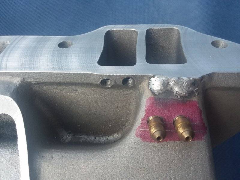

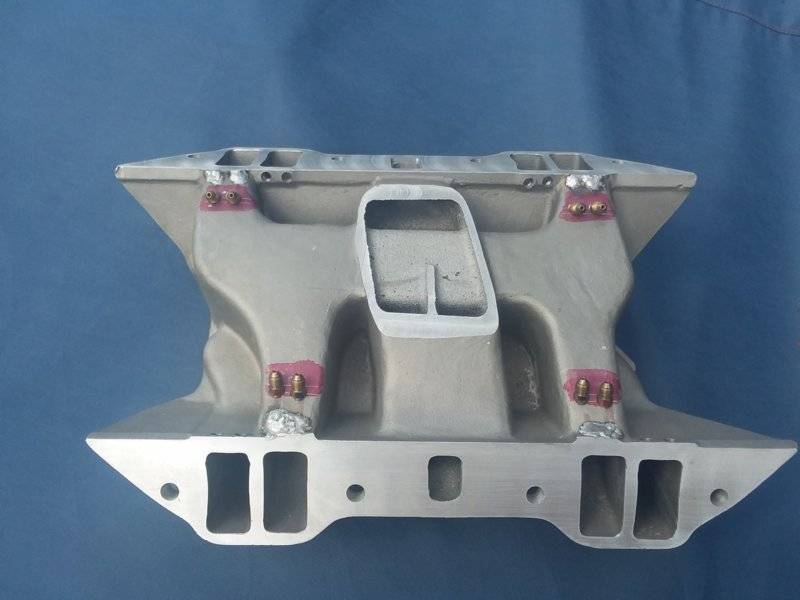

@PurpleBeeper ,@69 GTX , my manifold was kinda hard to get to, but I ran across it this morning, thought I'd post a pic.
The heat crossover had been cut, and the first attempt on the low-side ports have been plugged and redrilled. I think the problem was poor access to the high-side ports, interference with the valley pan
For what it's worth, this manifold has horrible core shift.
A hidden setup might work on a single plane manifold.
Might.
Might.

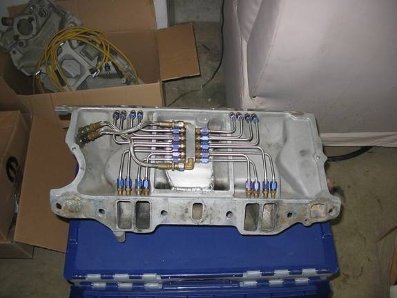

I remember posting this pic on this forum when I started a thread about hidden NOS on a 6bbl intake:
That hidden-under-the-manifold setup would work on a maxwedge crossram. Use an A&A , not an original.
