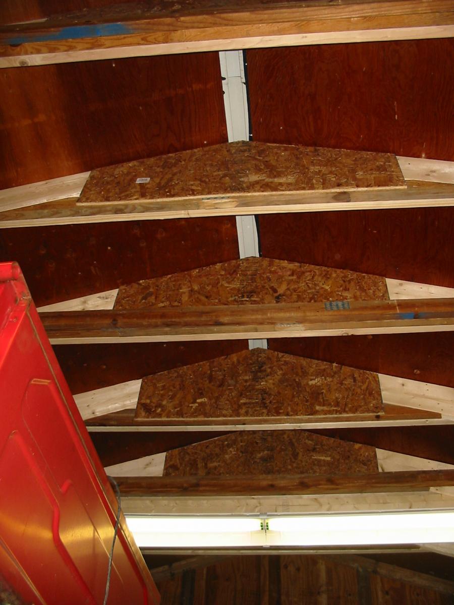

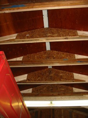

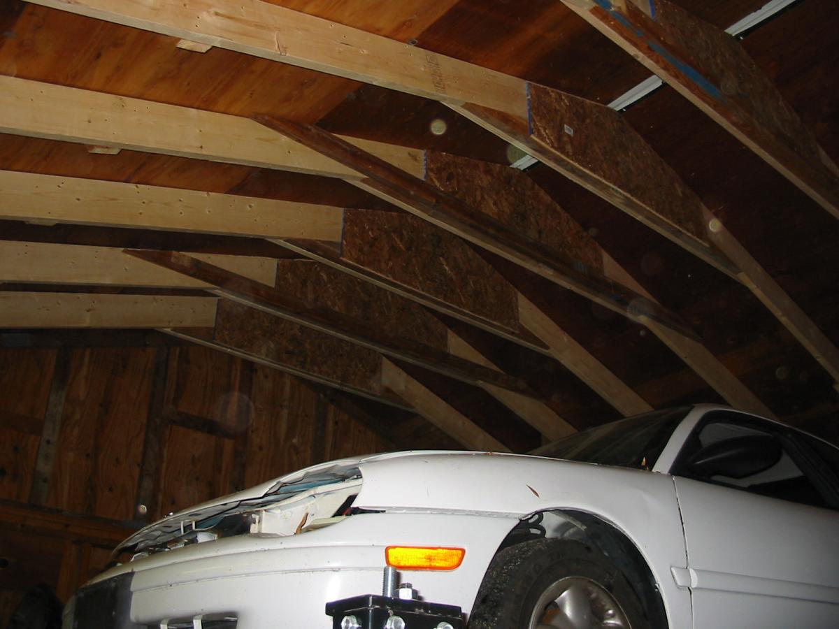

I am not sure what you are asking but, I wanted a 4 post lift in my shop and didn't have the overhead clearance to make it worth it.I had ceiling trusses and thought of raising the entire roof. Instead I converted the existing roofline to a rafter and collar tie set up. Got a Greg Smith lift and used that as a platform to help with the conversion.

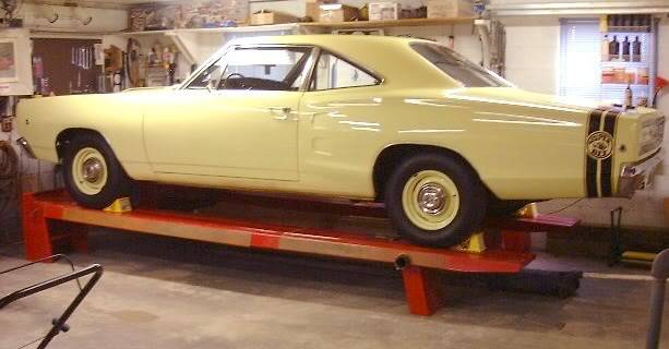

I went through the same thing with ceiling height considerations. I bought a Kwiklift. Not as convenient as a real lift but it's a lot better than jack stands. You drop the the back of the ramps, drive on, then jack up the ramps (at a connector bar), the drop the back legs. It's a nice sturdy unit and I feel very safe under it. I kept checking eBay and Craigslist for a used one and did buy one off Craigslist. Saved about $700 buying it used.
