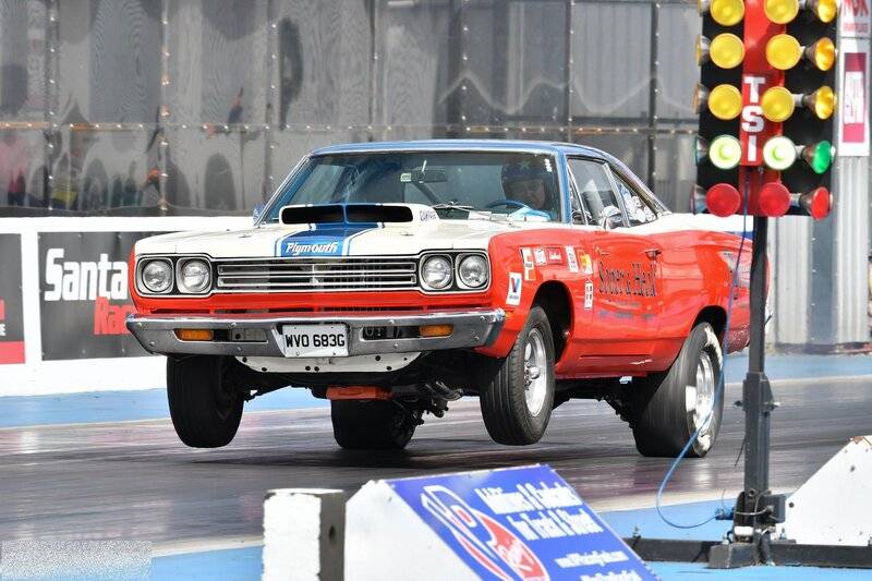

We run a low 1st in our 727 with caltracs/mono's/4.10's...SLR of 11+, 100lbs+ of mega block and stock 11" drums, 1.43 60's...3800lbs>
