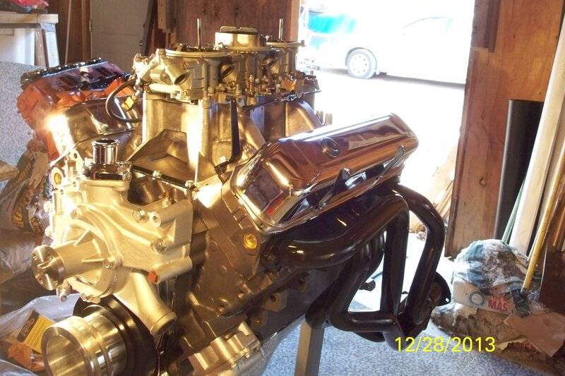

850 Demon on the 440 prior to efi. Worked good.
