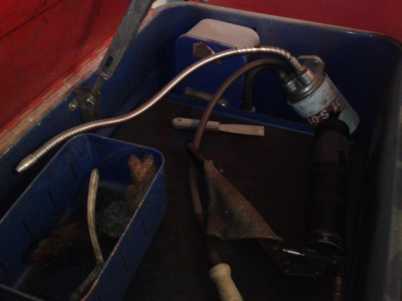

Ive had it for like 10+ years and the pump actually just runs off magnetism on mine , so no sparks to ignite anything.

I also plumbed mine with an oil filter after the pump. Works like a champ.
