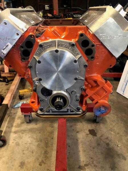

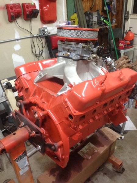

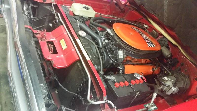

I have always used VHT Or Dupicolor. Used Dupicolor on both my Sixpack and Hemi engines years ago and both still look good. Their wrinkle finish worked great on the rocker covers also with some heat lamps and a heat gun. Wrinkled evenly all over.
