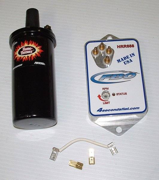

I have been happy with my FBO system. Custom curved distributor according to my engine build specs, adjustable for fine tuning. Factory harness plugs into module and the module has a rev limiter that staggers the cylinders that don't fire when you are up on the limiter.
Don is great for tech support too. I've had mine over 2 years.
And that's also no knock on Don's FBO products at all! His stuff is top notch. I run his limiter plates in a couple of my cars and they work great! I just wanted a box that looked more stock in my resto. If it was a race car, I probably would have used his stuff. I can say though the car runs as good as if not better with the new RevNNator than with the chrome box, without worrying of it dying in 3 months like the last one.
