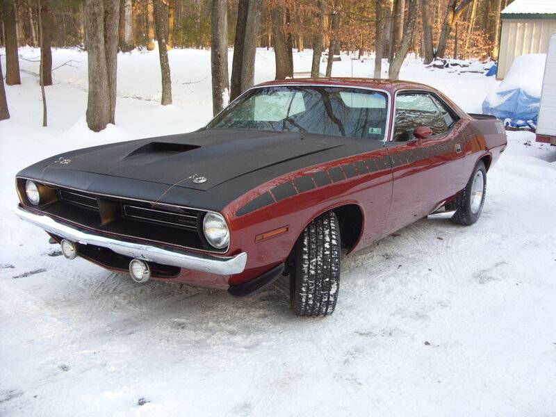

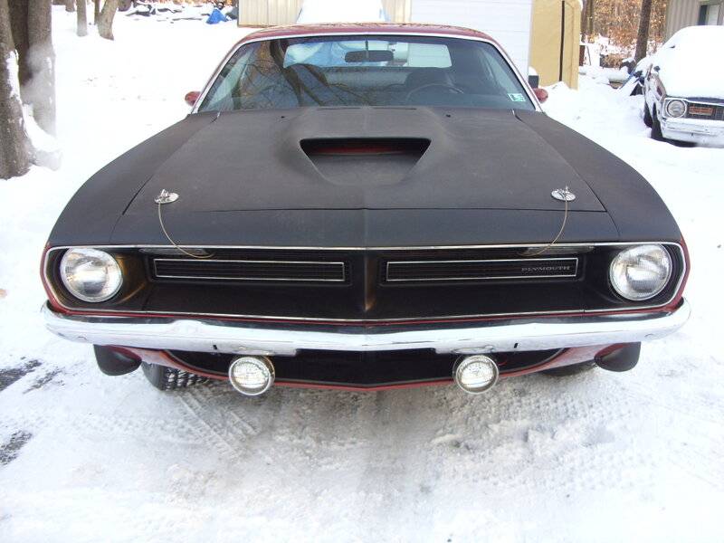

I did body & paint on a 70 AAR cuda. I was told that organasol is what the factory used on the hood & top of fenders. It is a textured black. Yes it is very hard to keep clean. I was used on some tail panels also. If my info is correct the AAR cuda & T/A challengers were the only ones that got that paint on the hoods. It is not a smooth finish.
View attachment 1090951 View attachment 1090952

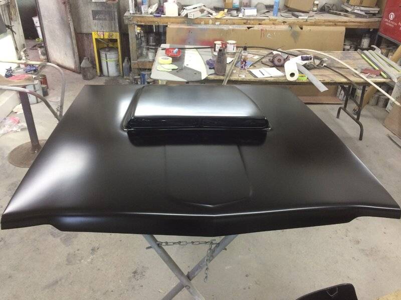

This one was just done in hotrod black and I’m happy I went that way. The original stuff looks cool but trust me it’s more difficult to maintain.
Hot rod black

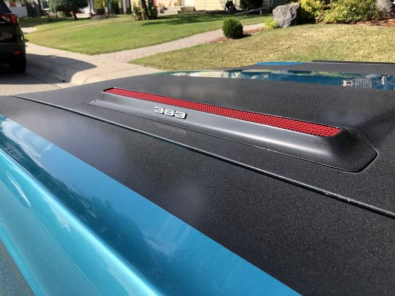

Oranosol. (Zoom in some and you can probably see the texture)
