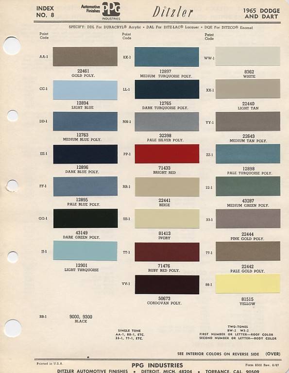

PPG was the original manufacturer of the 64 Dodge paint. You can find paint chip charts online, but the 64 seems to be missing. My 64 is ivory with red interior and through some research I found that it is exactly the same as the 65 ivory. Maybe black is the same, if so you're looking for "BB-01 Ebony Black 9300 9000".
Here is the chart I went off of:
