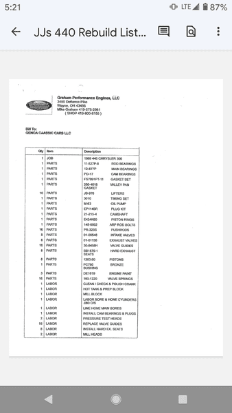

I had this done on my original 440. $3800, then $400 for break in.
