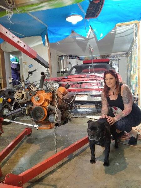

Motor and box removed. 4 speed taken to a local mopar manual box specialist

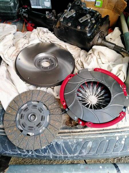

4speed had been rebuilt, altho very worn shift forks, and worn 2nd gear collar gear set. Also steel thrust washers were gnarled up into a lot of metal shavings. Very good original 2nd gearset and shift forks sourced and used.
Clutch had a cracked pressure plate, so a custom 12inch unit has been made by a local clutch specialist. Steel flywheel sourced with arp bolts

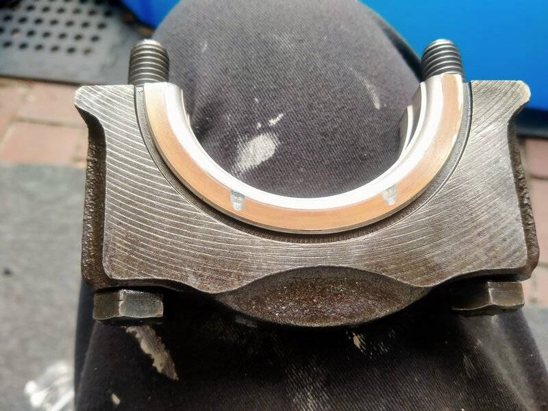

The 440 looks to have been rebuilt, but upon checking, the crank had .27 in of end to end float. The rear thrust face of centre main had almost worn away. The motor had full groove Clevite bearings, but only a standard oil pump, we think the motor may have had low pressure at hot idle. Crank still looked good
I installed a new set of mains, half groove this time. I just hope it runs for a couple more years
Replaced rear main seal, straightened sump pan rail, and rocker cover rails, new valley pan (there was no sealant along front and back edges)

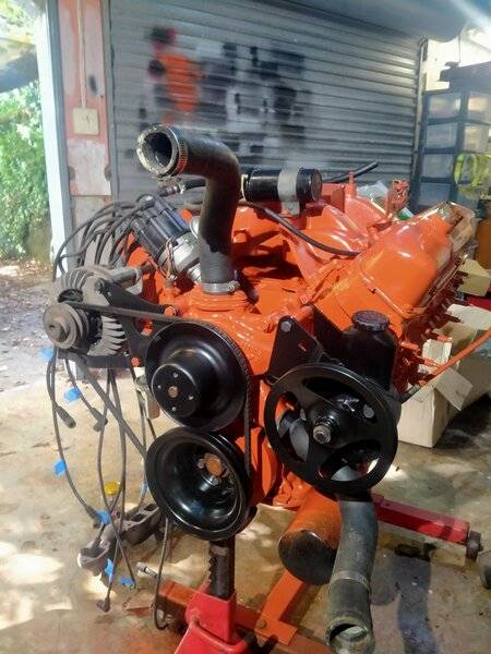

Painted in POR15 hemi oroange

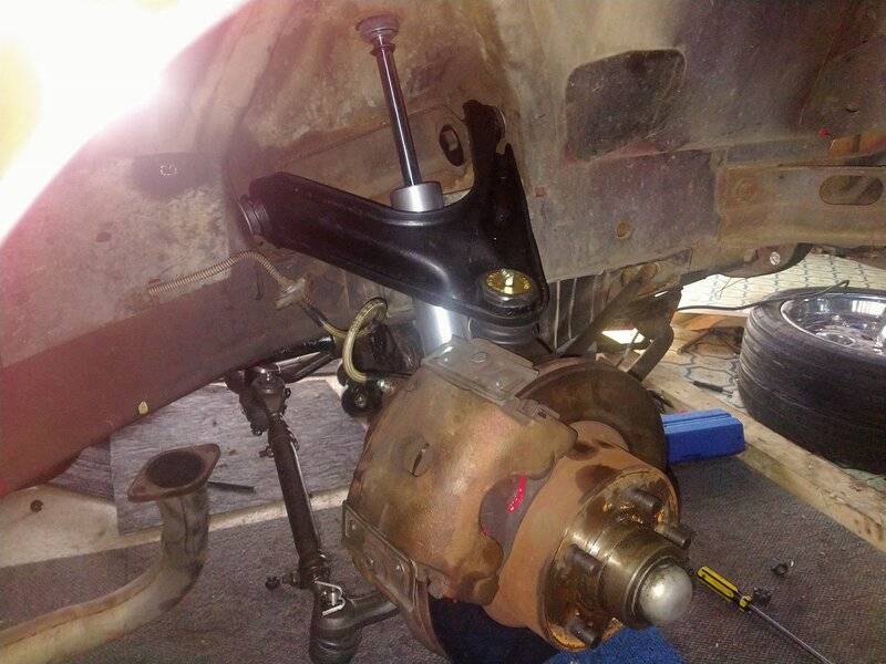

Converted to power steering, and fully rebuilt front suspension. Mopar performance .96 T bars, replace a arms, as top ball joint threads were non existant. QA1 single adjustable shocks front and rear

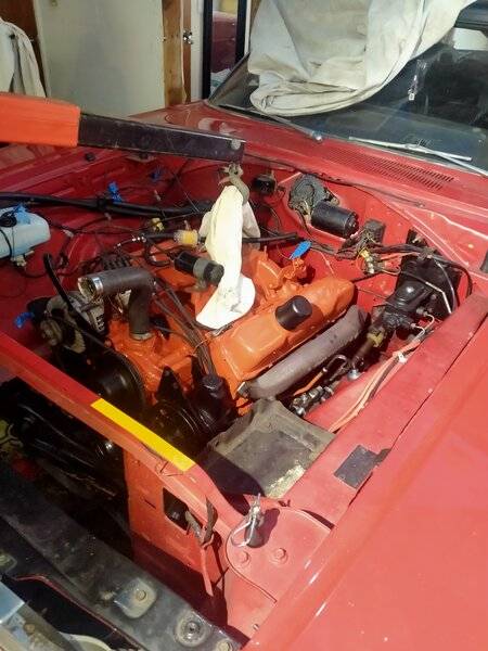

Drop engine back in

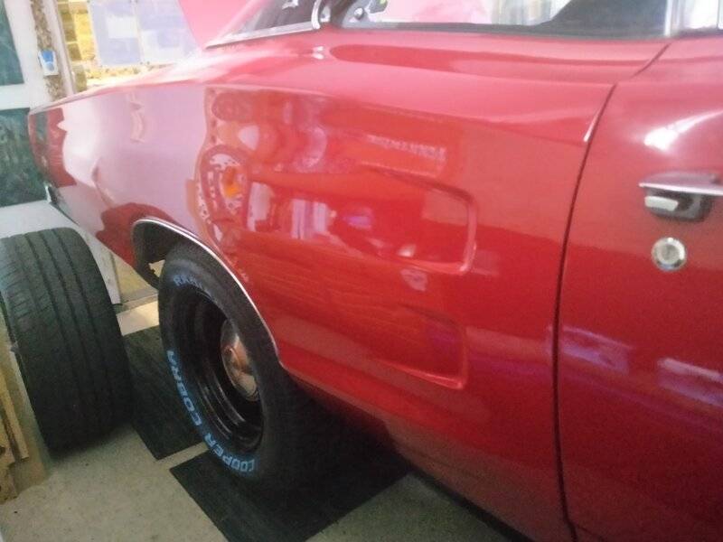

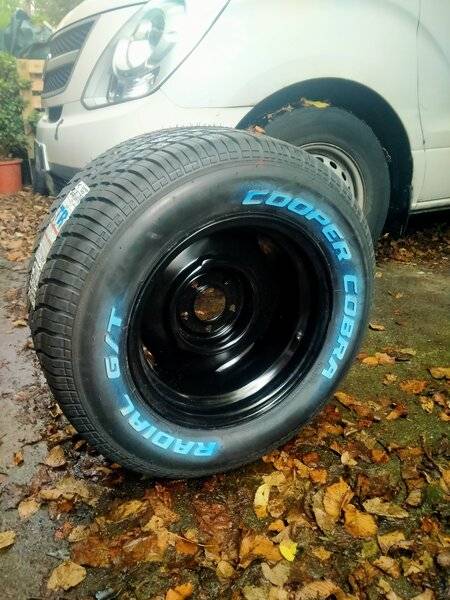

Custom 15*10 rear wheels made locally
Cooper cobra 295/50/15 fitted.

Nice project. When you said it had .27 end play on the crank, was the metric? If in inches, I would say that crank is toast. Or was it supposed to be .027? Up to you but on my manual trans stuff, including my daily driver Ram w/Cummins, the clutch switch is disabled so I don't have to engage it to start. Just gotta make sure its in neutral. Having a high pp load on the clutch puts a tremendous amount of pressure on the thrust main when its cold, not running with no oil pressure to feed/protect that area.
.27 inch.
Once new mains in, It was .04
The crank could well be toast, as I am very amateur with these things, and i am half expecting the engine to fail at some point.
I'm hoping it gives me a year or two, so I can save up to build a new motor, as my budget is completely blown at this point
Ouch. With that much even after the mains are in the future rebuild is no question. .004 would be groovy even up to .010 I think. Oh well, good excuse for improvements. Might be a good idea to bypass that switch so you extend the life of the bearings some. Did you put a new pilot bushing in while it was exposed?
