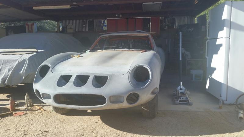

Ive made mention of this project before. Its Alpha One GTO glass body kit on a 280 Z. Joe Alphabet was the creator, HB, Cali in 1983, Hebuilt two cars for himself, a SB chebbie with inglese weber stack of 48 downdrafts, & other car had Ferrari v12 init.
The kits were to be made using Real Lusso trim......my Friend bought the first two kits(bought 3 z cars, i worked on all 3)kits Alphabet sold, with the OEM Ferrari hardware including competition alloy gas neck & cap w/ brass latch. Hot Rod did an article on Alphabets sb car, & shortly afterwards Enzo sued the **** out of Him for badging fakes witj *Ferrari* and ended the deal....what i didnt know until recently....these are the ONLY kits Alphabet sold b4 **** hit fan. Petersen Publishing is taking photos in Tucson of car & hopefully my Partner Paul, who is buying car, will be in Tucson by Tuesday, and He'll be featured making pick up. Car will be here in so-cal in less than a week. That engine/trans is a Toyota V-12, what is going in car, so basically, we're building a 'Japanese GTO'. All the GTO Z replicas out there,one having BMW V12 are fakes of the fake.....none sport real Ferrari gear. So Paul bought a magazine article, build follow, for the price of admission.......considering what He got......pennies. everybody paints them red, look at a Black one....which this certainly will be.....with the blue & red BRE stripes running diagonal down sides of front fender.....remember Pete Brock(cobra daytona coupe body)campaining the Datsun 510 & Z cars in trans am, scca? Pete Brock penned out the cobra coupe body by gut, But also directly off the GTO, even though they dont look alike, the space they displace is very close, there are comparison angle shots on web. The GTO was a 180 mph car, the cobra coupe 185 mph...5mph margin for 24 hours.....thats fukin[IRacin! Brock said of cobra, " yup we squeaked past on top end, but it was like road racing a pick up truck for 24 hours"[/I] We were going to build a cobra clone motor, complete w webers & dry sump, but then this toy v12 came to our attention from our Guy here, Photon 440. Toy makes these engines currently for their domestic mkt, do not export....outfit we're getting unit from in Texas that does JDM motors, guarantees motor/trans to be less than 50k miles.....after looking inside one of our toy v8's with 125k miles & no visible wear on cam lobes.......this will be a seriously fast car. Engine is 5.0 ltr/300 ci, 300 hp w 350 tq stock, but this wont be stock......whole ball of wax is around 2500 lbs finished......power to weight on this & the chop bug will both be about 5 to 1, GTO might edge the bug a little.....Z's have a hell of a racing history, very good platform.....this aint no bradley gt.

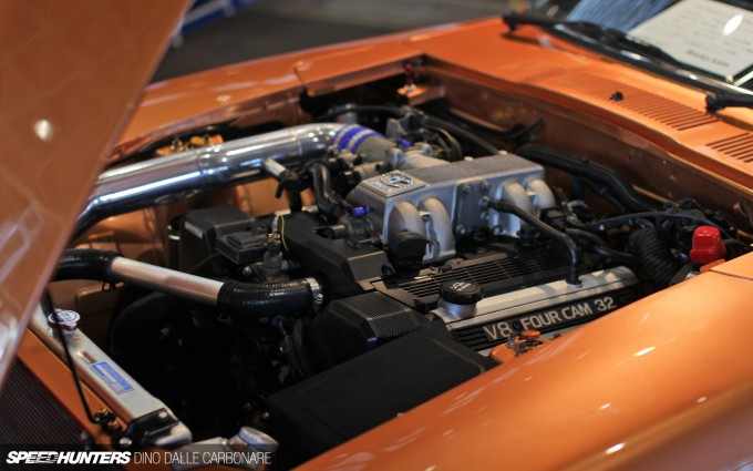

(one pic is toy/lex v8 in Z car)

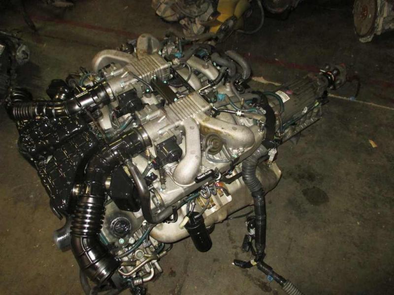

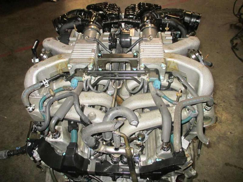

Anyone not sure what Bladecutter is talking about for engines, in Japan the Toyota Century is a luxury car/limo way above their own Lexus in status and price. Sized like a Bentley, Benz or Caddy, it's the car of choice over there if you have status.

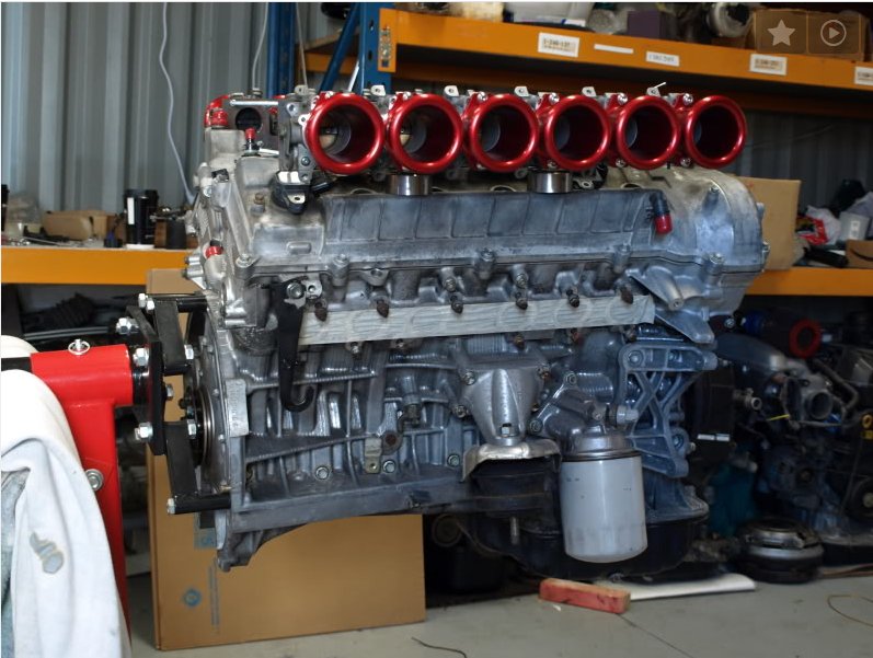

A set of carbs like this would fit pretty well, don't you think?

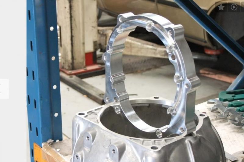

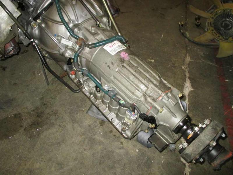

Sticking with the automatic, Bladecutter? With an adapter, you could be running a R-154 5 speed, or better yet a V-160 six speed which will laugh at the 1000 hp. you get after the twin turbos come on... :)
Hey Photon! Yeah, i dont know, the stock trans is 4 spd auto, later models are 6 spd autos. There is also the combo You sent me before, the Guy using a turbo supra manual(i think 6spd) with that trik double plate clutch, & i think He said there was a 3 plate that could also be used. It's going to take some thunk, and money is already hemorahging. The magazine has already asked an ETA of having engine sitting in car. Hopefully Paul is out of here mon nite. Picking Car & trailer up as pkg, so His drive over will be unencumbered. It's going to be a very busy year between the two cars & sculpture. Gotta map out the chassis/cage mods before we think about eng/trans resting spot...but like in both GTO & Daytona Coupe, probly trim and resectuon cowl/firewall to get driveline as far back as can. I think We can get close to a 55ft/45 rr bias. And even may be able to get the V12 behind frt xmember,& down. The plan right now for both cars is dry sump/remote oil. Machine some flat billet plates with crank/rod clearancing, approx inch plate will do it. For the bug, it's important for ground clearance ossue alone, eliminating pan & sump frame will make the engine ground clearance consistent w rest of car again.....6 " less in height w/o it......and Who wouldnt feel better with 12-14 qt system, six finger, six finger man alive, how did i ever get along with just Five? Going to be a long haul with a buckload of head scratching & anger management at intervals, but getting there is the adventure, i cant wait to See the GTO. Ida never thought......Thirty Five Years....God Is Good, has Always covered my ***.
Oh yeah, that sidedraft setup is so f-in ***** looking! I dont know yet if we have the width needed, plus moving eng down will make width limitation too, if its possible, but its more dough than down draft. Kinsler ball parked 10-12k for V12 dwndrft efi, if that is Who we choose, i really like Their stuff & the vibe, Quality simply costs.....& its all USA gear.....Patriotism Babee, dont care if overseas is cheaper, its not custom machined port matching & spacing, not billet fuel rails, not a lot of what i looked at of Kinsler, aerospace toleranced hardware...pay to play, buy USA. This week is smokin so i wont be around much. All the Best to All!

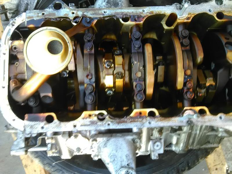

IMG_20160321_184538.jpgIMG_20160321_183459.jpgIMG_20160321_182940.jpgIMG_20160321_140812.jpgIMG_20160321_140734.jpg

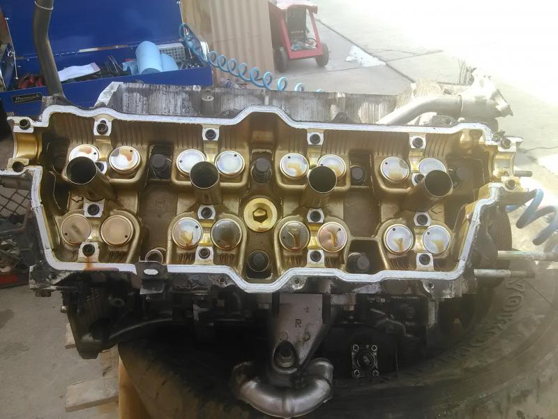

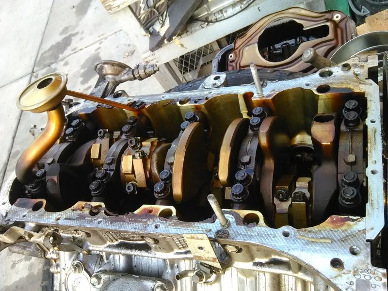

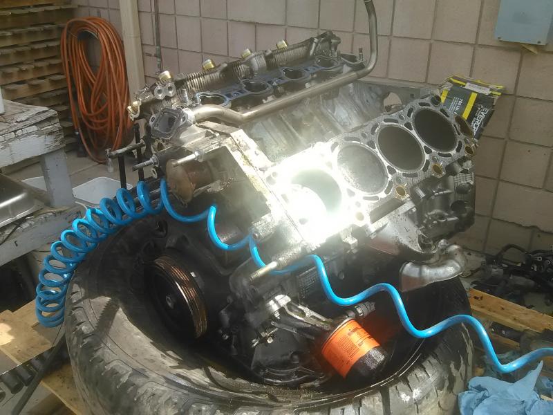

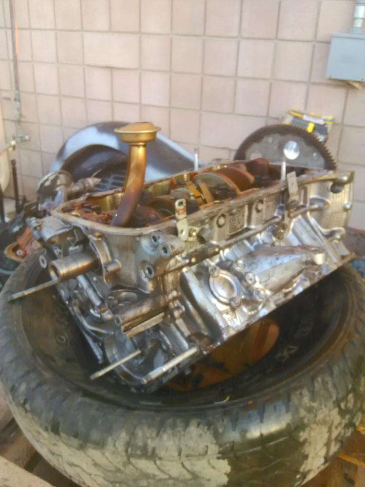

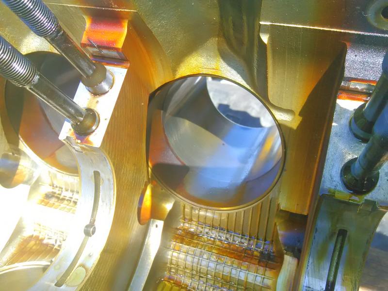

John broke down the v8 w/issue today...what i figured when isaw shredded, burnt cam belt, engine overheated & driven until it quit, oil burnt but still viscuous. The sleeves are in great shape, the cam bearings are fine, see a touch of wear line but cant feel ****. Notice the Six bolt main caps? Both v8's are 125k mile motors, mine has no issue, run, leakdown tested so i think mine is good to go with trik induction & exhaust. The v12 bottom end i would guess is similar, additional 4 holes. Heads are different...v8 is hemi & v12 is squish wedge.
Photon440 just informed me that the stock rods are good for 500 beans..car should be around 2500 lbs. turn key. Should work well.

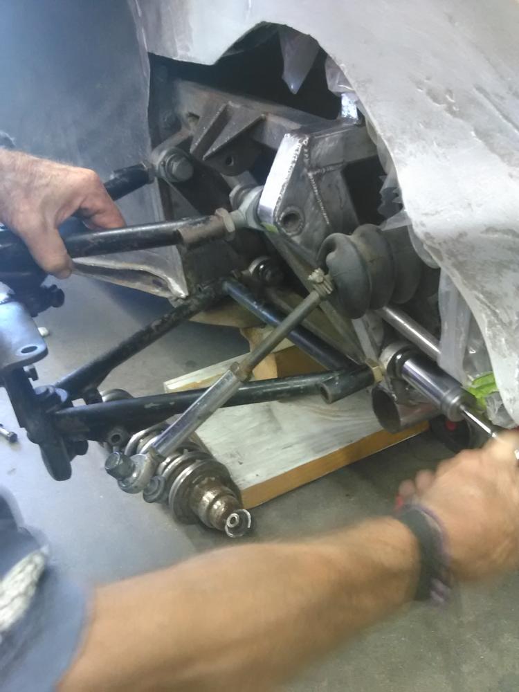

Front end on chop sure is cake to r&r, learning to tune it wont be as easy. Rollin, busee week churning........Peace...bc
